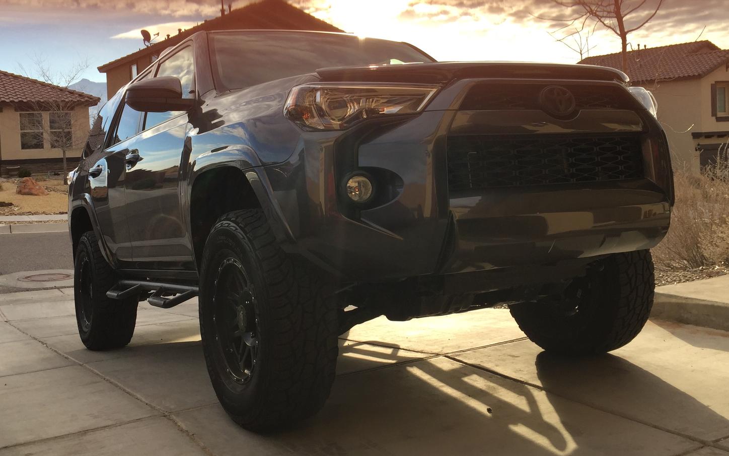

Here's mine with 20x9 Black Rhino Sidewinders with -12 offset wrapped in 275-55 Nitto Terra Grapplers. As you can see the tires stick out about 1/3" after the fender.

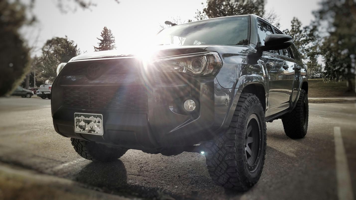

I'm running 285/70/17 on 17x8 with 0 offset. I agree with your opinion on the factory "tuck." This isn't the perfect angle in the photo, but it's the best I have handy. I'm happy with the stance, tires sit very close to flush with fenders

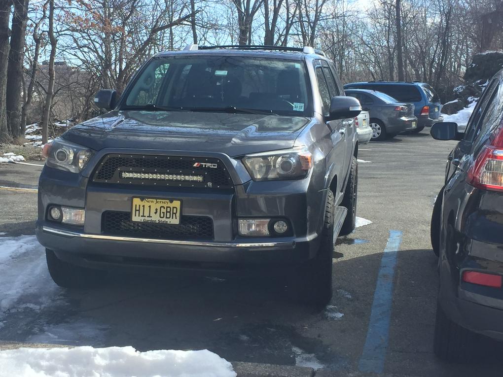

SCS SR8 wheels with 285s... stock height (just trying to find time to install my lift)
Specs:
17 X 8.5
4.30" backspace
-10mm offset
I'm really happy with the stance on these. I agree that the stock wheels are a bit too tucked; I wouldn't want them any further out than what I have now though either.
