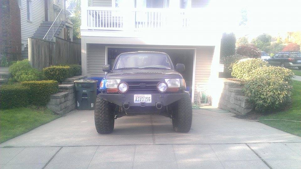

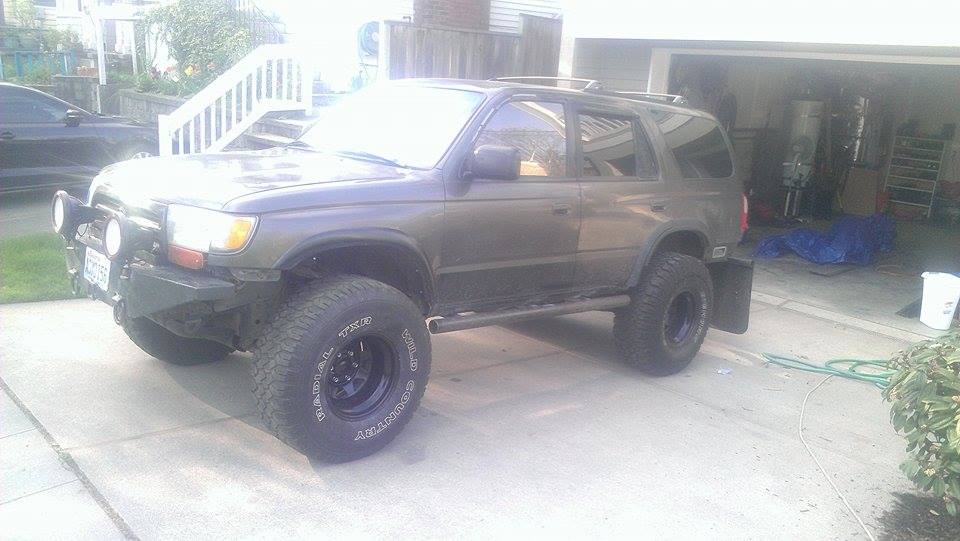

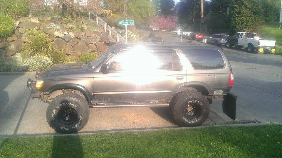

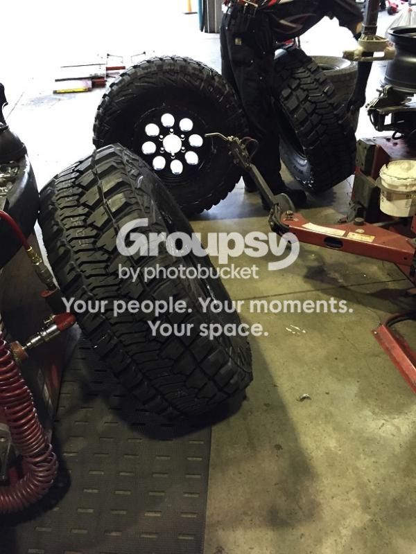

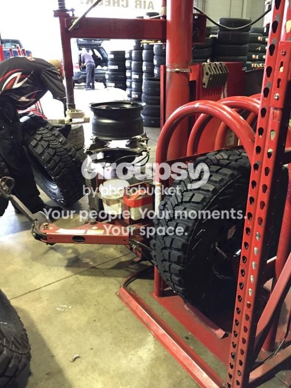

Getting the wheels and tires mounted
Bringing it home in my truck. Can you tell i'm a fan of MTR's? haha
Mounted:

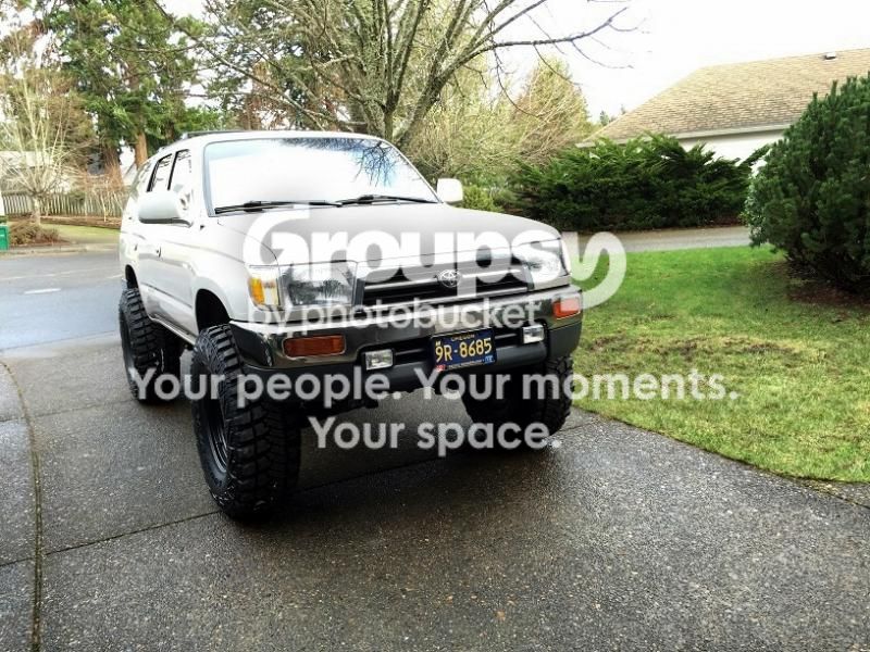

I added a couple questions to this I thought were important.
- What wheels are you running? Mickey Thompson Classic III 16X8
- What is the backspacing of your wheels? ET0
- Do you rub the frame at full lock? Yes
- What specific tire size and brand are you running? 315/75/16 Goodyear MTR
- Do you rub the UCA at full drop? Nope, toytec/SPC UCA's
- Are you running wheel spacers, if so how big are they? 1inch on the front
- Are you running a body lift, if so how much? No
- Auto or manual, and what R&P gears are you running? Manual, 4.10
Mounted:
Looks sweet! To go along with your other good info, I would love to see an explanation/pics of what you did to make room for the 35's with no BL.

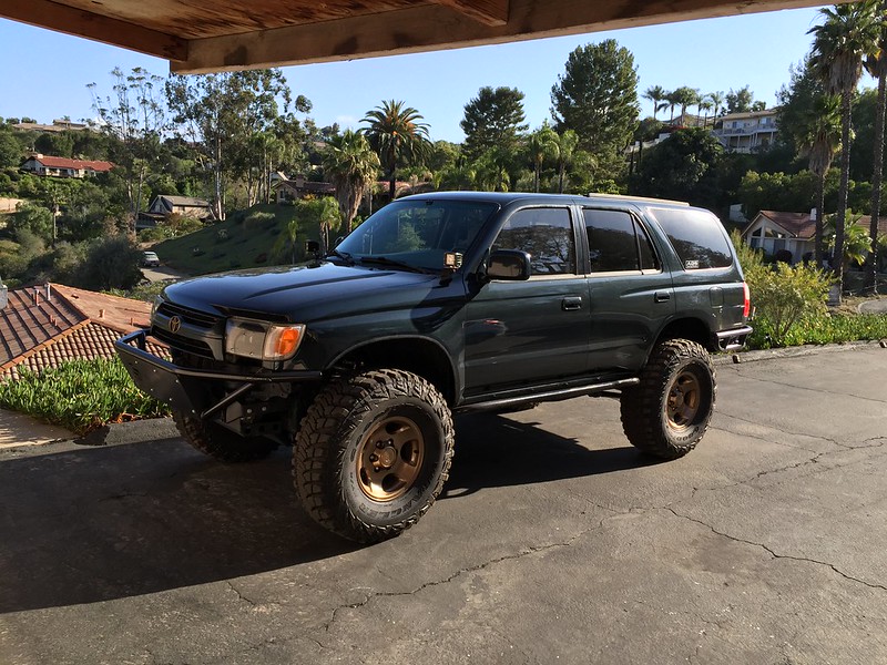

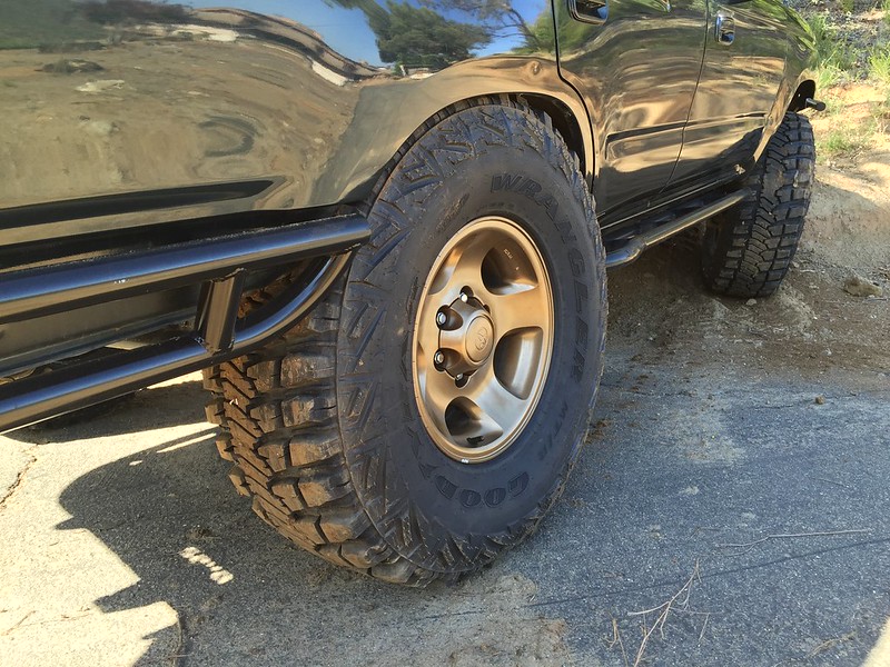

What wheels are you running? LC80 16X8
- What is the backspacing of your wheels? 4.5"
- Do you rub the UCA at full drop? Nope, Camburg Uniballs
- Are you running wheel spacers, if so how big are they? No
Untitled by Connor Rhoades, on Flickr
IMG_5126 by Connor Rhoades, on Flickr
