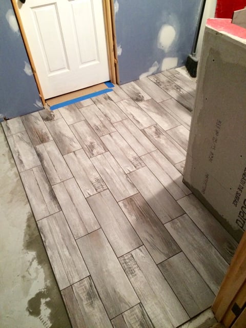

Made some pretty good headway in the bathroom over the past few days. Tough when I have a real job I have to go to and can't just spend all my time banging this out. Anyways. Plumbing and electrical are both done. Drywall is hung. Tomorrow I'll mud and sand. Monday starts tile work. A week or so and it should be done.

Hey thanks man. It is coming together well. I got the rest of the floor down today and got that grouted so just the shower left. That shower floor is definitely going to take a lot of grout and I'm sure it's gonna suck grouting it. But it'll look pretty sweet when it's done.

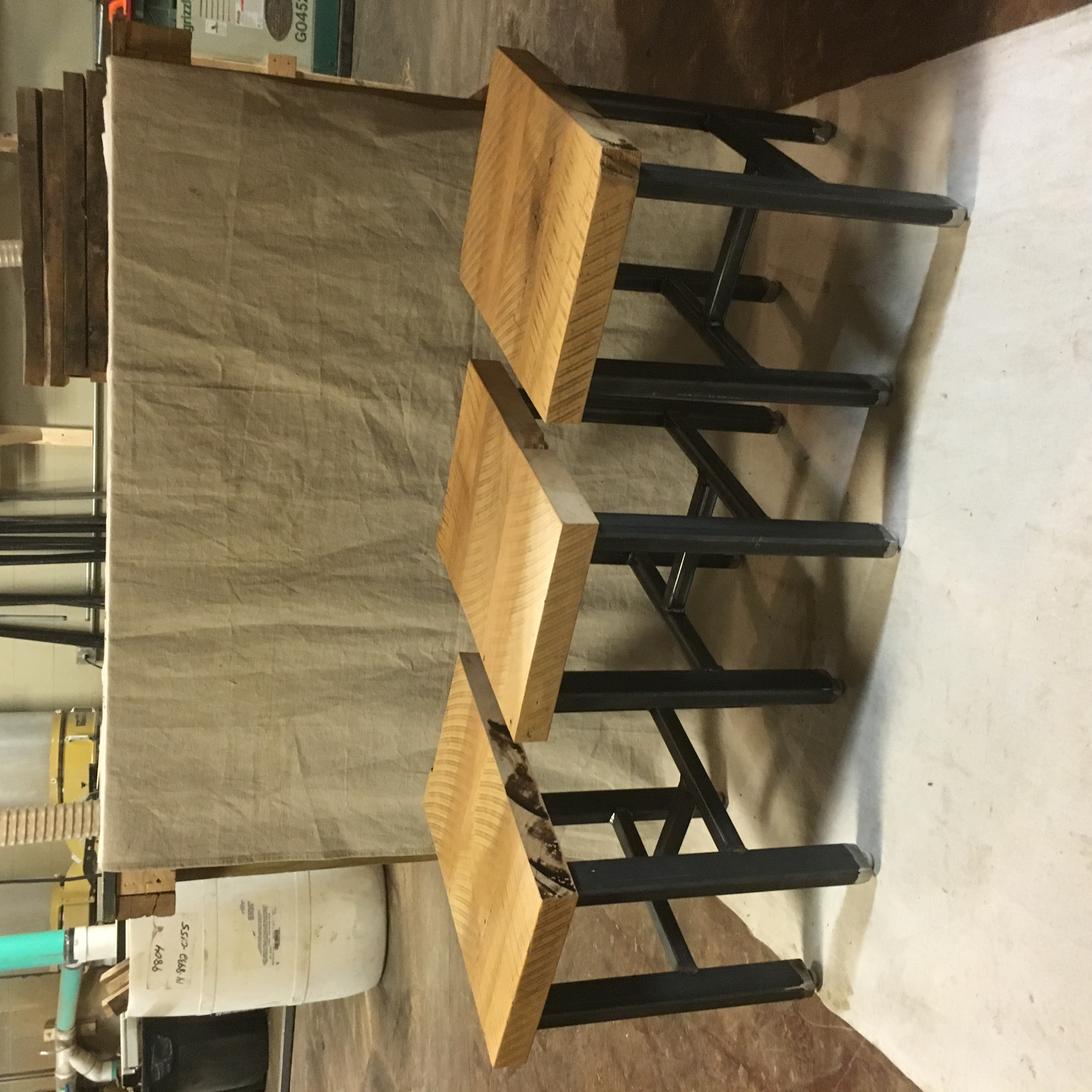

I made some benches recently, dining table height or could use as an accent table. Took them to a pop up sale and they sold for $400! Mind you I used a scrap piece of 2" panel I just cut three 12x18's and a bit of 2x1 and 1x1 steel tube lying around the shop.
Hot damn cash in scrap!
