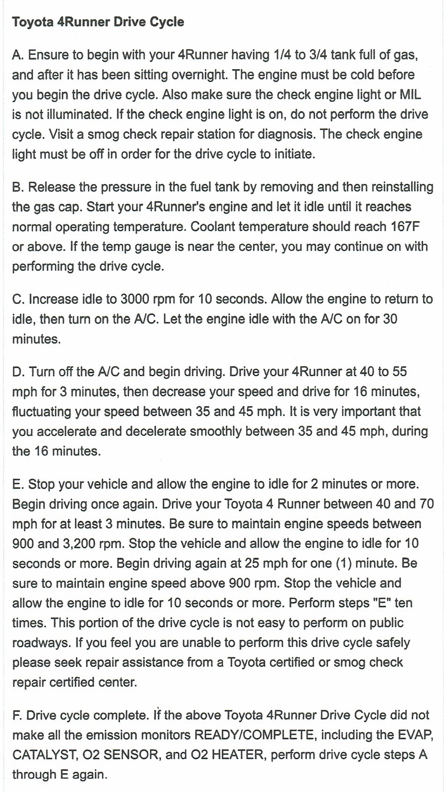

So, im trying to get emissions test completed on my 2001 T4R.
Ive been to the test station 3 times and still after 200 miles of driving the Catalyst and O2 Censor still show as Not Ready.
I found a link in one of the threads to the "official" Toyo Drive Cycle, problem
is that it not going to be easy to do here in Houston.
Is there any other way or recommendations?
Thanks As Usual...

On some Toyota’s if your catalytic converter is marginal on being bad it will not run those 2 monitors or you may have a bad O2 sensor. For the cat monitor you have to be at operating temp drive between 40-55 mph for 3 minutes and then drive for about 15 minutes changing speeds between 35-45 mph and it will usually pass at the very end of the drive cycle if you are monitoring it with a scanner. I have set the monitor even if I deviated slightly from those speeds and stopping at stop lights when driving for the 15 minutes just don’t accelerate erratically, but I believe you have something going on. Good luck.

Keep driving it for a bit. There's no way you can safely do that cycle in Houston, but after a week it should be good.
If not, I'd just focus on the O2 sensors; in Harris County, model years 2001+ can have 1 monitor 'not ready'. (96-2000 can have 2 not ready)
I had an O2 monitor not ready on my 99 for over a year. Passed inspections, etc, no problem. Finally replaced the sensor while diagnosing a fuel pressure issue, and the next day checked the monitors on my Torque Pro app and the monitor cleared. So the sensor was bad enough to not be ready, but not bad enough to throw a code.
I'd also recommend getting a Bluetooth OBD adapter and the TorquePro app. One of the default screens shows the readiness monitors so you don't have to waste your time driving back and forth to the station. It'd be around $20 total.
