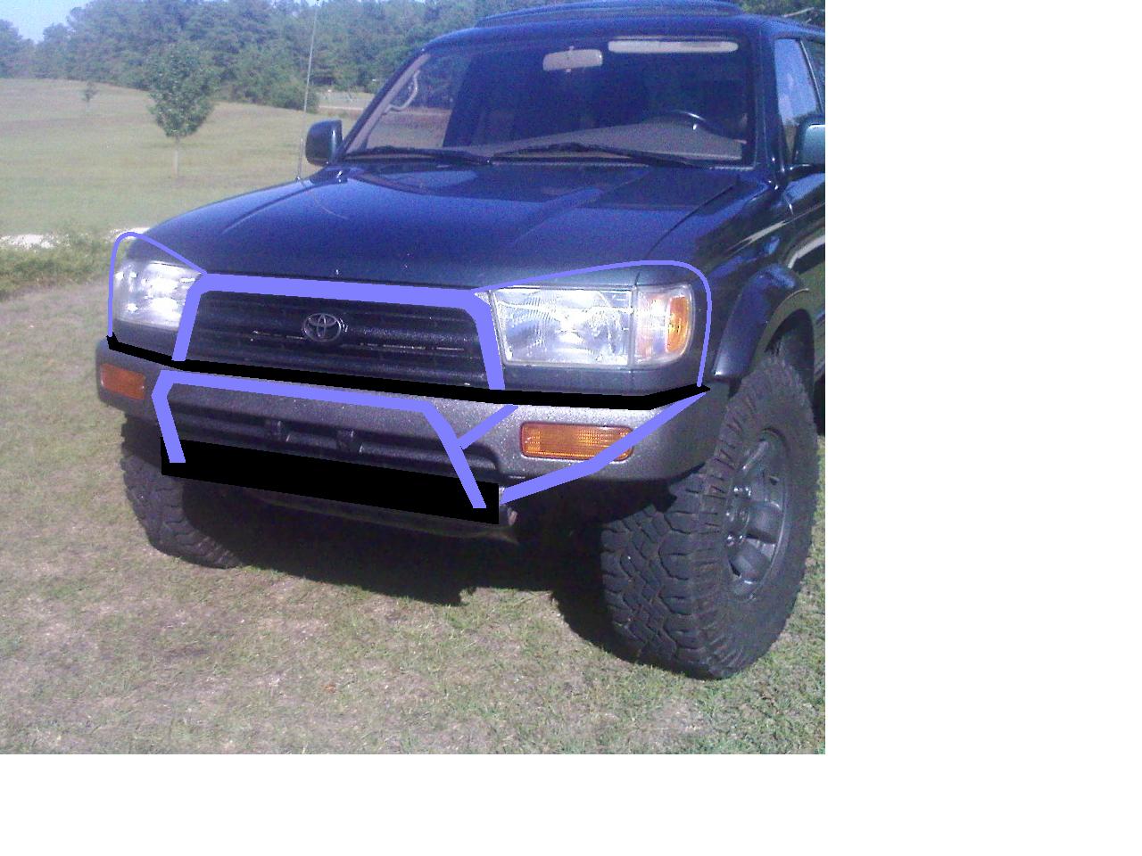

Offroad bumper
Rough sketch but I like the metal tech all-pro combo

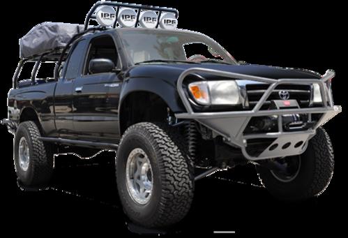

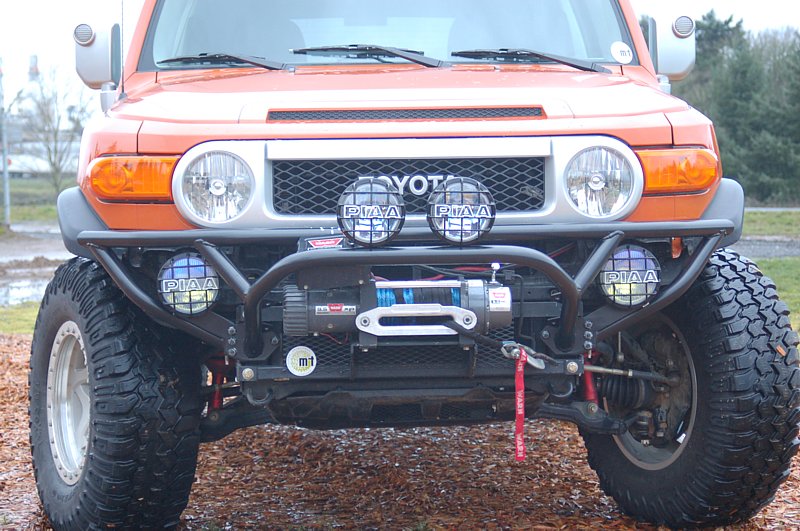

Well Damn. And I thought I had finally made a decision. Any bumpers out there that look like the AP one and maybe have the same features that fit 3rd gens?

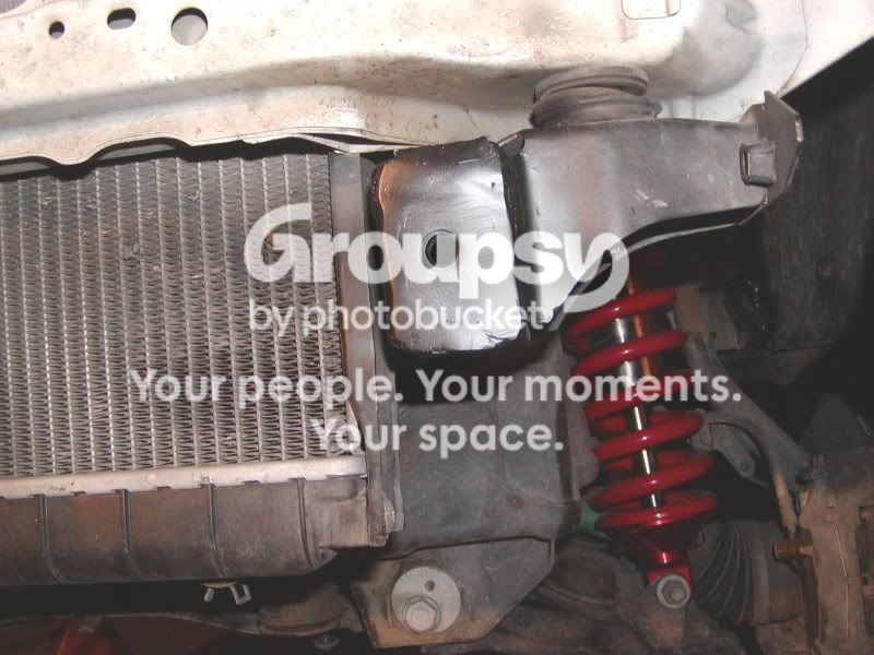

its very easy all you need is a angle grinder, cut the frame end cap off so its square, and weld on a plate with a nut in the middle and cap the frame off
SnuffyBU221.jpg~original
Mine has a bar across the front so would that have to be removed too?
Sorry its the only pic I took when my bumper was off but you can see it.
