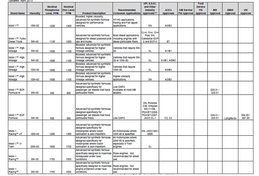

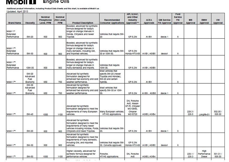

Not starting an oil war or debate here. I just want to add to the collective knowledge of fellow motor enthusiasts.
I personally do not use the M1 0W-20 Fuel economy because of its very low Phosphorus and Zinc content(ZDDP). The major elements that prevents meta to metal wear. Here's the Mobil1 chart of its ZDDP contents on oil I personaly only use ones with no less than 1000PPM to keep the wear to a minimum.

Which oil do you run then? I thought ZDDP was more important for older engines, but isn't as necessary in newer engines like ours. Can't other additives in the package reduce metal to metal wear the same as ZDDP?
Is there any brand of 0w-20 that contain <1000ppm of ZDDP?
I thought the general consensus of TMO 0w-20 or even M1 0w-20 is that they were pretty solid oil choices for us.
I think you guys worry WAY too much about this stuff.
"Keeping the wear to a minimum" cracks me up!:sorry:
Yeah, let's get 800 000 miles out of this engine instead of 700 000. Then 4 years later, this same person will be buying another vehicle anyway.
