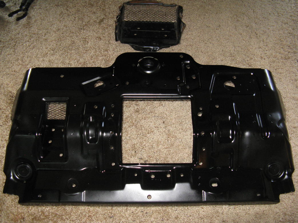

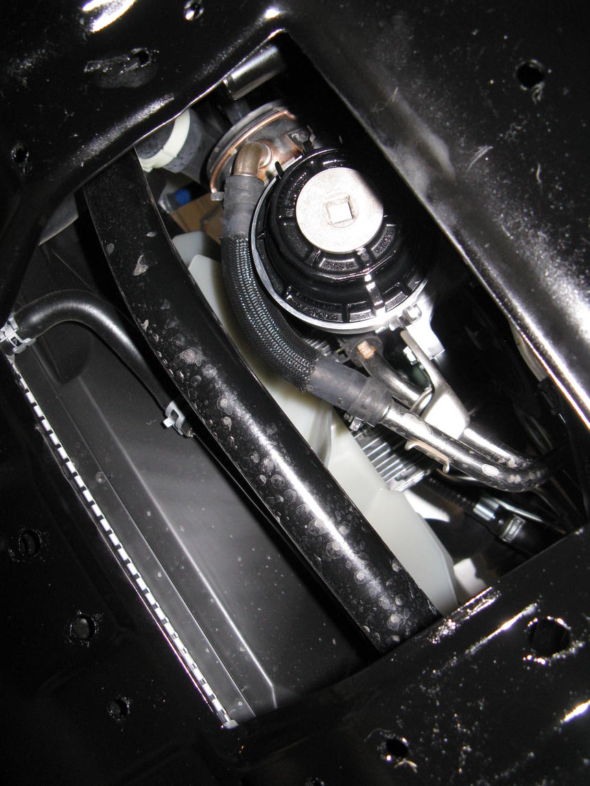

Access Oil Filter Without Removing Skid Plate
I'm Just gonna throw this out there for the mechanical guys who change their own oil on a regular basis. Having to remove the skid plate EVERY time you change the oil filter can be a hassle if you don't have a lift in your garage. So I made a slight modification to my skid plate in order to access the filter canister with the skid plate in place. At my first oil change, I removed the skid plate and completed the oil and filter change. Before I reinstalled the skid plate, I drilled out the 16 spot welds holding the air dam to the center of the skid plate. Once this was done, I found surface rust between the bottom of the skid plate and the lip of the air dam. This was a perfect opportunity to undercoat the skid plate and the seal the exposed metal. Please note the pictures below, nothing is affected by removing the wire mesh air dam from the skid plate except now you can easily access your oil filter without removing the plate. Maybe I could sell this idea to Toyota ???
Very nice! You beat me to it....
Was gonna try that with nutserts inserted in the drilled out spot welds to reattach the air dam and/or take out a little more and fabricate something that can be removed easier than the whole skid.
I've only got 900 miles on my beast so my mod will be awhile.
Nice Job!
I like your idea in some ways. Bet the dealer lube techs would love it, but wonder how air flow is affected with the air dam gone?
I'd bet a buck that in an engine warranty situation Toyota would dishonor the claim.
