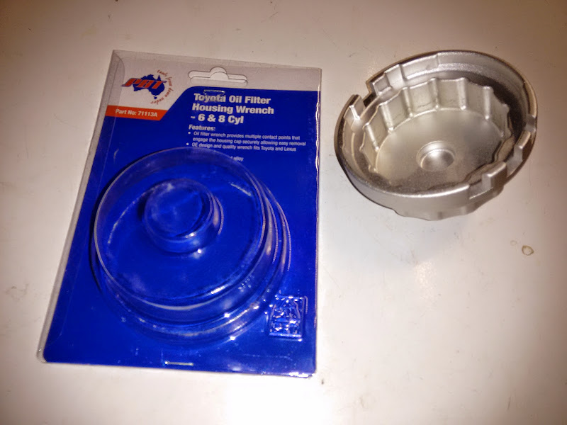

Filter Housing Wrench
Well this time around for my fall oil change I got a proper wrench.
Turns out because I had not over torqued it putting it back on the last time (see my older post for the massive grief I had on a Sunday the first time I tried this after the dealer monkeys over tightened it) it came off like butter. Could have actually used my old hacked up adapter but this was much nicer because of the way it grips and stays on and the fact the housing has a lot of friction the whole way out and in.
Probably could have ordered it from Amazon or somewhere cheaper but I got a deal on it (~$26) at a Napa in Edmonton and I had again left things a bit too late; but at least a Saturday!
