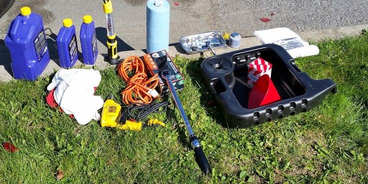

Like your kit. I've got the same torque wrench I think & jar of anti-seize. :)
I opt for the Toyota 0W20 though. Good price and two 5L jugs do both my 4Runner and Yaris almost exactly.
