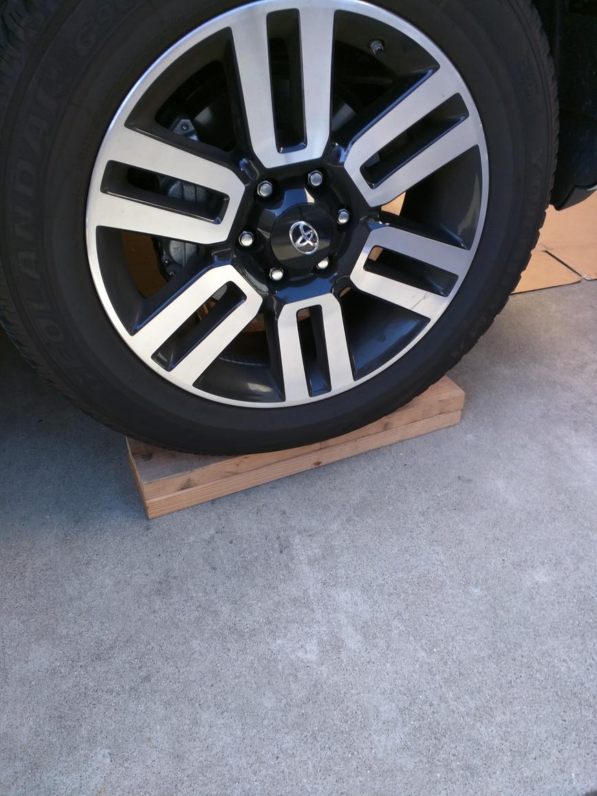

One tip...
to get the skid plate off you need just a tiny bit more clearance than what a stock ride height 4runner has.
Antman suggests grinding part of the tab off of the factory skid plate. I'm being one for not wanting to cut or pernamently change a brand new vehicle I decided to just get more space.
Just drive or jack your car onto two 2x6s stacked on top of each other. This gives you an extra 4" to be able to tilt your skid plate and unhook it from the cross member.

Actually 3 inches. Thanks for tip - haven't done 1st change yet and was wondering if I wanted to grind on skid tabs.
