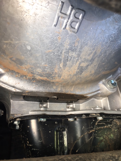

Do you guys/gals ever notice any buildup/sludge in this area when you are changing your oil?
I have a 2016 Trail with about 8K miles. The dealer did the 1st "complimentary" oil change but I'm convinced I should be doing this on my own. Great write up and instructions will help me no doubt!
But definitely checking to see if you think this is normal/acceptable (picture below).
Thanks!
