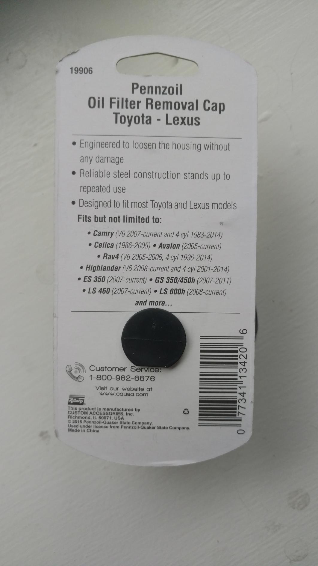

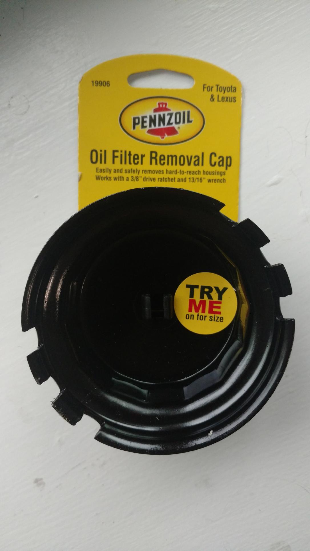

Yesterday was my first DIY oil change on the '15 Trail. I've always been a Tacoma guy and we know how easy the oil change is on that. Well, the 4Runner isn't that bad... if it all goes well. Thanks to Antman for this thread, really appreciate the time and effort you put into helping others. Well done!
First thing I noticed... the dealer broke off the bolt on the passenger side holding the plastic cover to the skid plate. Great! So, I commence to removal. After getting the plastic part off, I go to remove the skid plate and the front passenger bolt is stripped. Some techs at some dealers really take no pride in their work. This guy had to know he did this but let it slide... probably figures the next oil change, someone else will get it. I'd like to snap the little tw@t's finger. But, ok... I can fix both, just not that day. I'll pick up a tap and new bolts, easy-out the broken piece and be back in business.
The rest of the process was straight-forward. I was happy to learn that O'Reilly's sold the Toyota tool (from Pennzoil) for $9.99 in metal and fits like a glove. With the first change done and having the correct tool, the next one will be easy. I will not be trusting the local dealer with the rig again. When I was in NH, that dealer never let me down. Now in TX, I'll steer clear of Round Rock Toyota going forward. Not sure how the service is at the Austin dealership...
Here's that tool from O'Reilly's.

toyohtadude: Thanks for info on filter removal tool from O'Reilly's--didn't think about looking there!
Same tool I purchased (same retailer), it works like a champ! I've been to Maund Toyota service several times and they are likely the best in our Metro area. That said, my 4R is usually worked on only by me.
