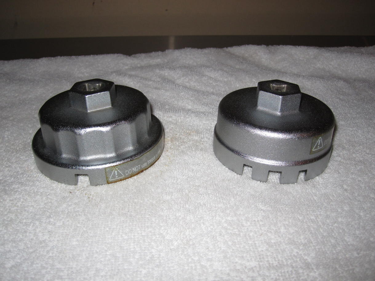

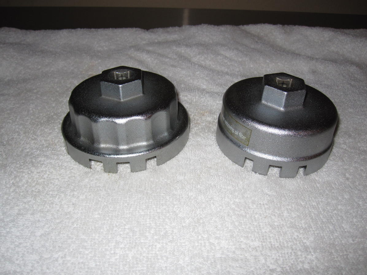

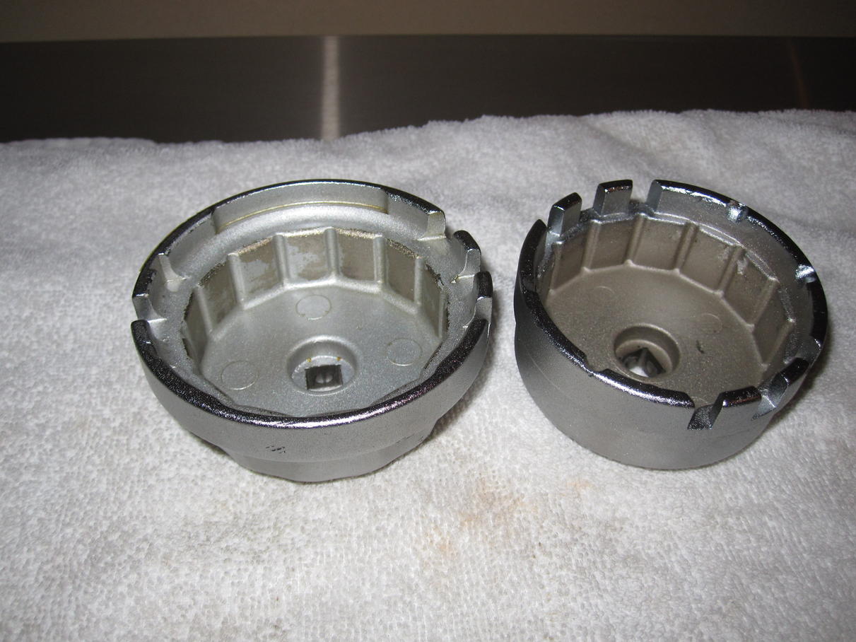

That Pennzoil oil filter tool looks different; there are two sets of three tabs. My oil filter wrench has one set of three tabs and single tab just like the oil filter housing for perfect fitting. In addition, my tool is much thicker compared to Pennzoil and not as sharp around the tabs.

My wrench looks like the one at the top, except it doesn't have the teeth.
My wrench looks exactly like the one that Antman has in his manual. Why do they put teeth on these other wrenches, just so people can break off the tab?:noidea:
If you have a good oil filter wrench (i.e., tight fit), those teeth will provide extra grip to loosen the oil filter housing. IMO that Pennzoil oil filter does not provide tight fitting at the housing base. In addition that filter tool is too thin and puts too much shear force on the filter housing tabs. I have a set of two: one for small I4 and the other for bigger I4 or V6/V8. I believe Antman filter wrench is very thick like my set sans teeth. I have not encountered any issue with my tool.
