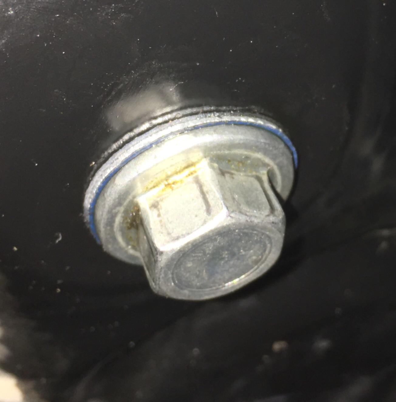

Driving front end up on RhinoRamps will help with visibility and getting under, but any opinions on what this upward slant trajectory on front end does for completeness of oil drain?
Also - it might be come obvious when I unscrew the drain plug but my guess is blue side of gasket (as shown in Antman's pic) goes against the pan.
Thanks

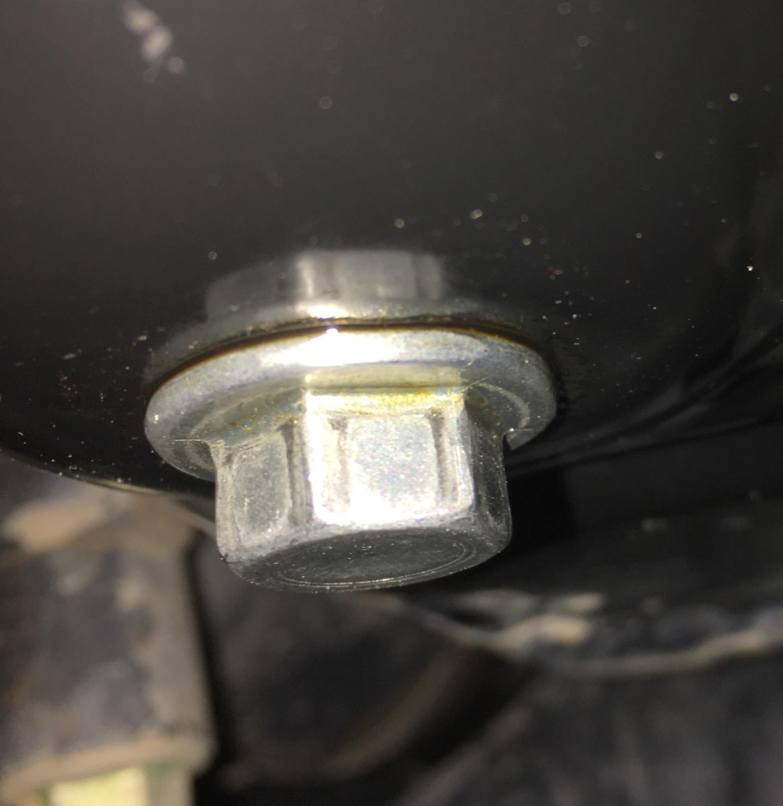

A bit of a stuff-up today with my oil change. When double checking the drain bolts after filling with the new oil, I couldn't see the washer on the oil pan plug. Sure enough, it had fallen off when I went to install it.
No worries, I tried the shop vac trick I had seen on youtube and it worked flawlessly. We have a long filler tube so the additional rag was not needed.
https://www.youtube.com/watch?v=IAAKh9Q-KNw
I might be getting too old and stupid to change my own oil:(
good you took the time to check your work.
sh*t happens which is why I leave all the covers off a few days and crawl under to check for any issues ...
