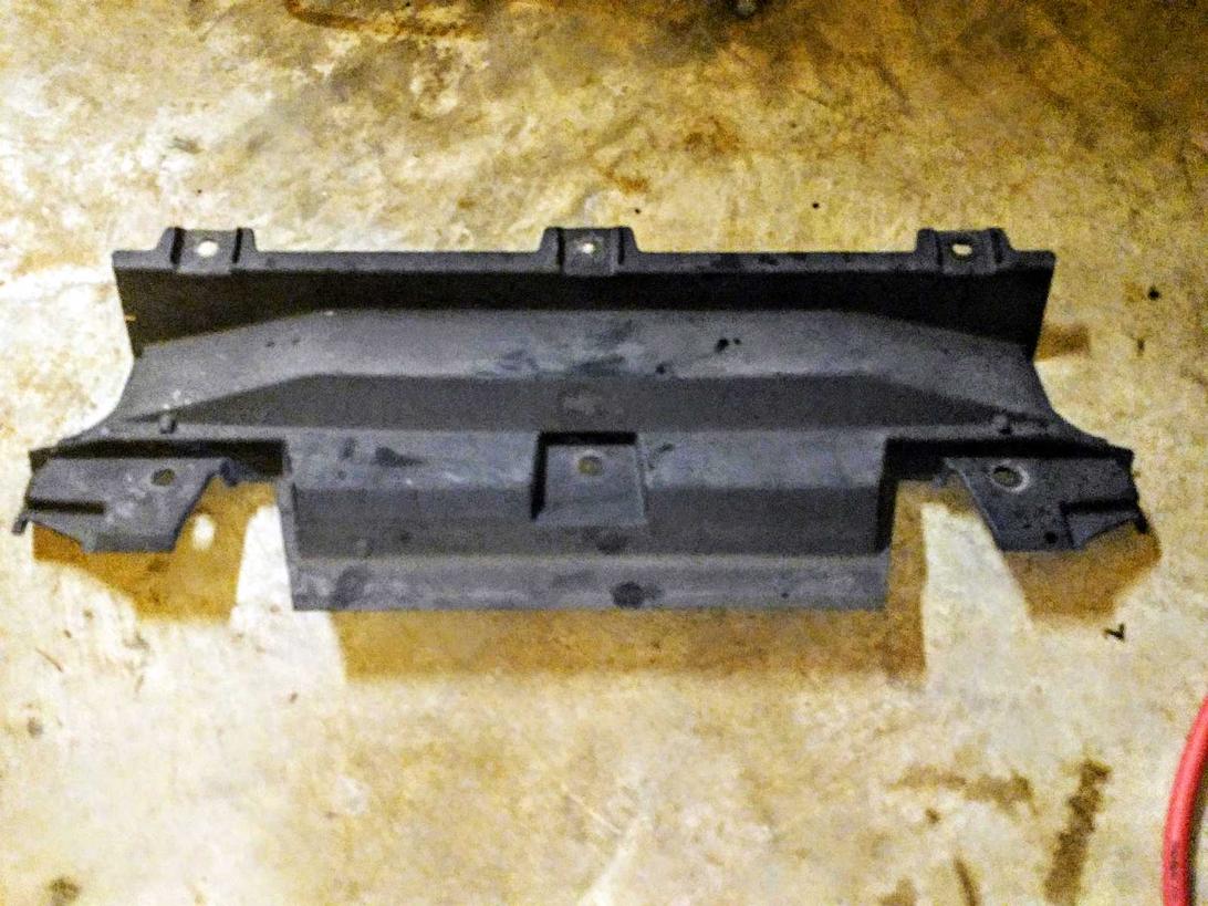

I assumed [MENTION=170444]dayprota[/MENTION] was talking about this thing.
Actually you have to pull out the center like I show in the picture then remove the outer ring. To install place the outer ring first and insert the pin.:hello:
Just checked and of course you’re right. It is not a 2-stage push pin like the ones on the radiator cover like I was thinking. However, that method has always worked for me. Push in on the center and the male pin pulls right out without any resistance. I probably just have a defective part.

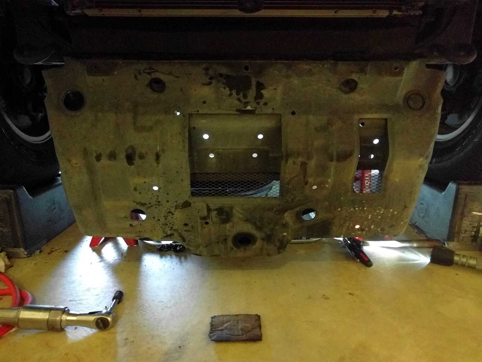

Front skid OEM filler plate
Thanks.
Okay, now I see the plastic part you guys were talking about. That's the plastic filler plate in front of the front skid. The top edge connects under or behind the bumper. It's got to be removed before removing the OEM skid plate. It doesn't fit on the RCI engine skid plate because there's no holes for the bolts or that plastic pin. I bought the RCI filler plate to keep brush off of the radiator. I have an extra filler piece if anyone wants it. Otherwise I have to recycle it.

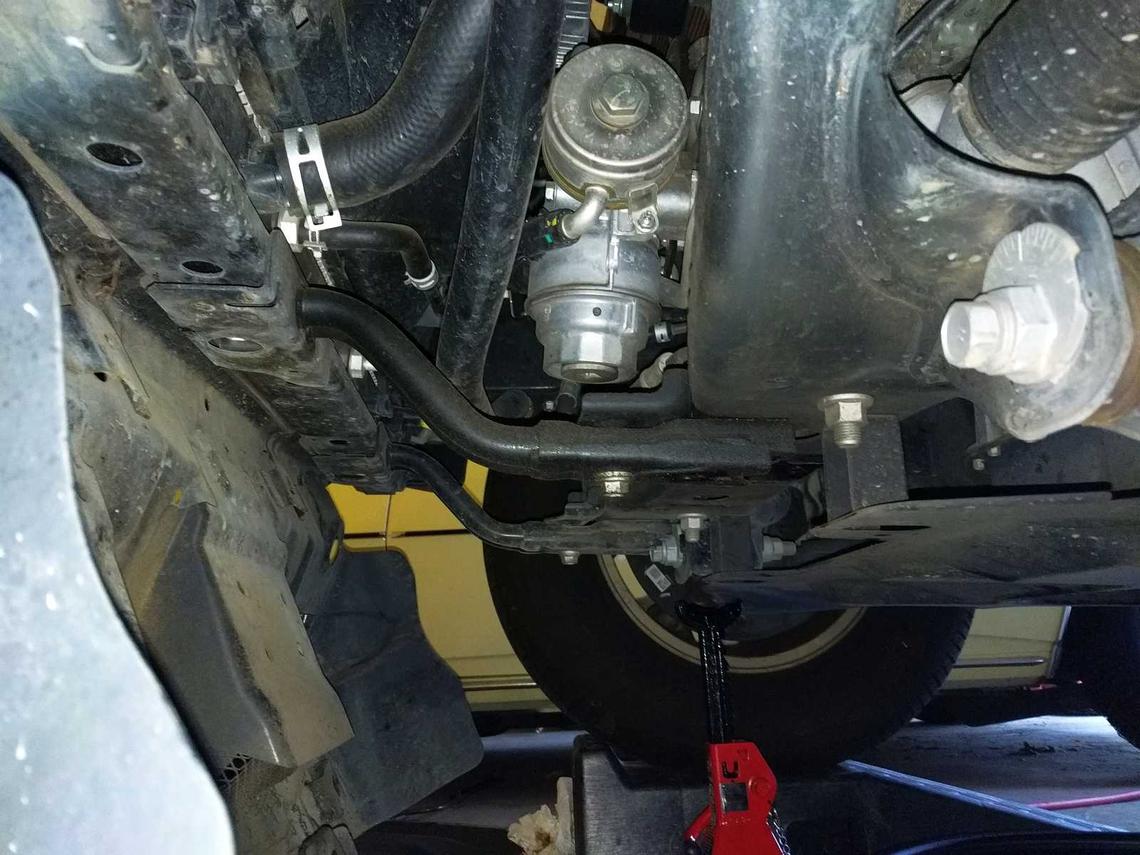

Using your ratchet and 64mm filter wrench (make sure your ratchet is in "reverse!"), remove the filter housing. It will be tight, and stay tight until it's almost all the way off.
CONTINUED
Thank you for stating that, i thought mine was messed up or something...it was so tight until the o-ring was past the lip.

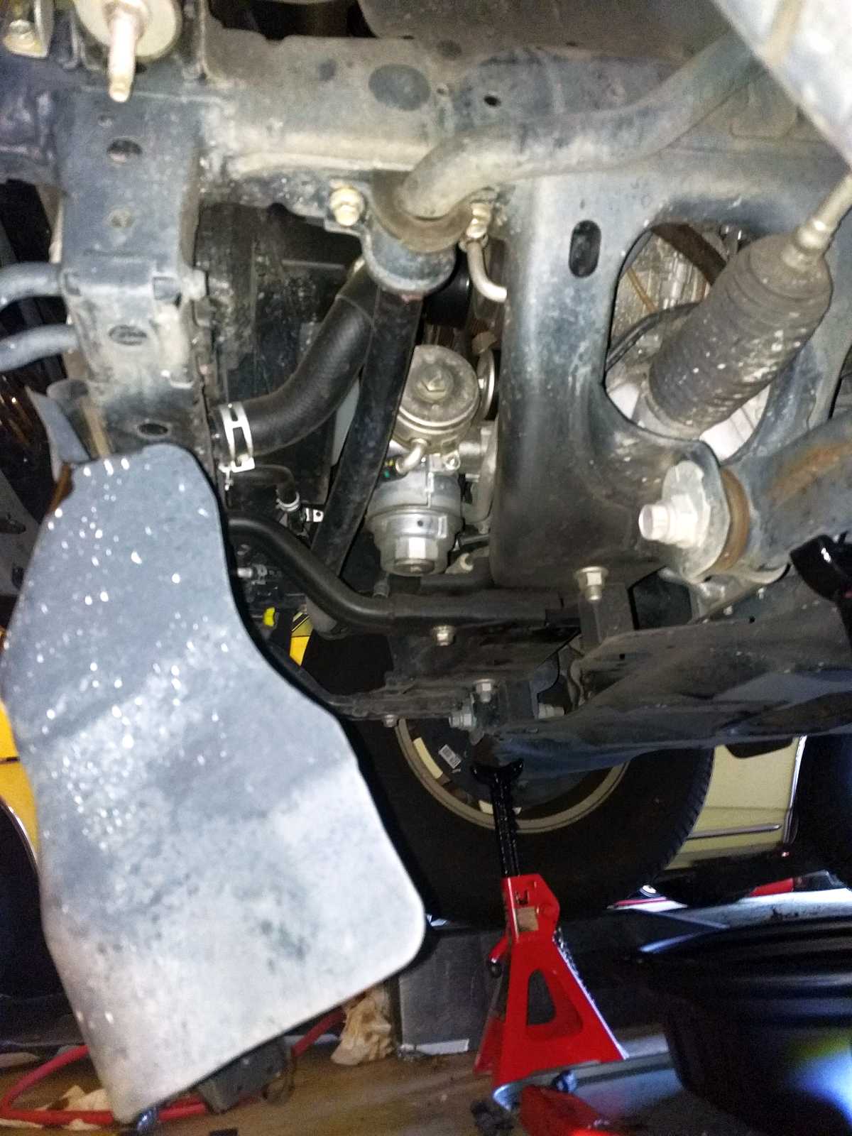

I did the change on ramps, so didn't have to remove the skid plate, just let it hang.

1. My plastic cover under the bumper only had five bolts and the plastic push pin to remove, not seven?

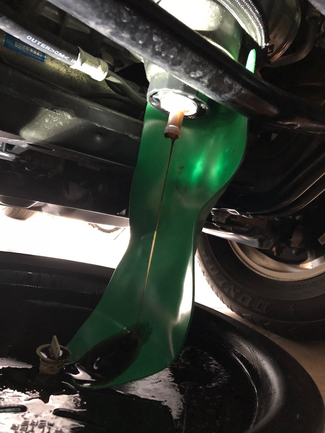

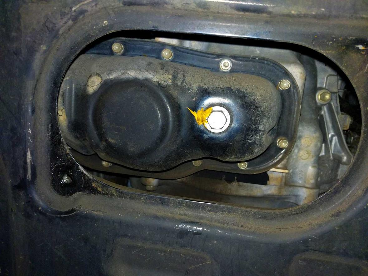

2. I forgot/missed needing a new gasket for the drain plug, so cleaned the old one stuck to the pan and reused. How much of an issue is that? Also, the drain plug seemed to have been glued down on one edge, is that a dealer thing? (see picture)
3. One of my Skid Plate bolts was missing, threads were fine so I guess someone lost it during the first 102,000 miles. Put it back together without it, will get a replacement for the next change.
4. There was a piece of cardboard duct taped in the back center of the skid plate which fell out. Strange?

Missed buying new drain plug gasket.Will check for leaks periodically.

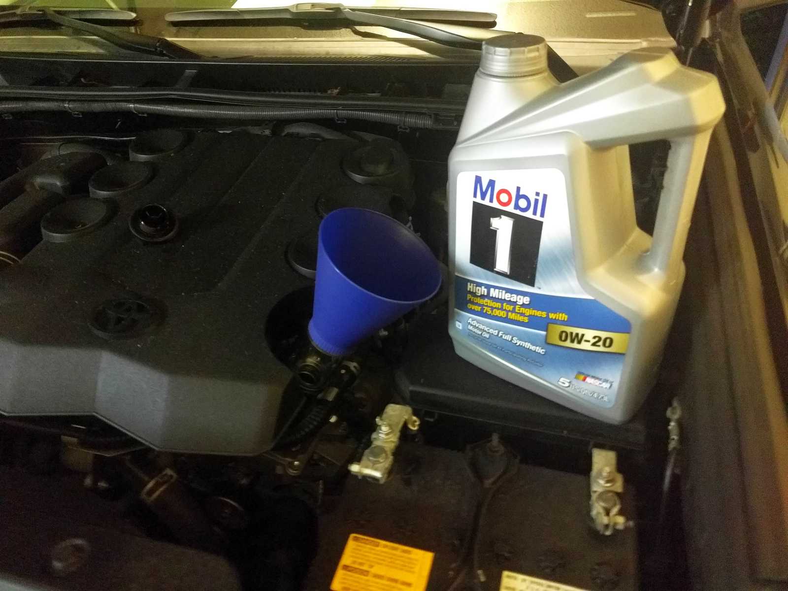

Motivx Engine Oil Funnel @ $14.95
https://www.amazon.com/gp/product/B016FVJUX0
