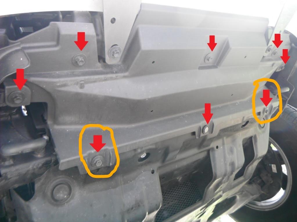

My wife did not want me to change oil in her 4Runner as long as the extended warranty was effective. Today was the last oil change, so I elected to check and test items before this oil change was performed.
First, I checked four skid plate bolt (2-12mm and 2-10mm) threads. There was enough damage to require chasing the threads with dies, however, bolts were still serviceable if torqued carefully.
Last, I applied a dab of nail polish on two 10mm bolts circled in the photo to see if those bolts were loosened during the filter change.
After servicing, I noted that both bolts were not disturbed. I showed a tech manager the undisturbed bolts and asked how the filter could be changed if these bolts were not removed. His reply was, "We used to remove 7 10mm bolts (shown at arrows in the photo), but we found a way to remove only two rear 12mm bolts, rotate and lower the back of the skid plate, reach in and remove the oil filter housing (when vehicle is high up on a hoist). My finger picked up some old oil when I reached into the recessed hole for a 12mm bolt. Looking at the oil filter housing was inconclusive due to a fresh rain shower, so, I accepted his explanation.
Is the tech manager's explanation reasonable and correct?

Thanks TOYO74. In the link you gave, Hawaiian4Runner wrote, "My 2010 Trail doesnt look like that either. Mines is like Antman's. Gotta remove the plastic cover to take off the 2 front bolts on the skid."
Our 4Runner is like Antman's, so now it appears the oil filter was not changed. I'll know for sure when I do the first oil change myself.
Mine is exactly like yours and I do not remove the plastic cover. I put the vehicle on ramps, remove the two bolts and clip closest to the skid plate. Then remove the bolts from the skid plate and let it swing down. That is likely what they did.
That is how I also do mine. Saves time and is easier than getting the front hook/hinges to line up.

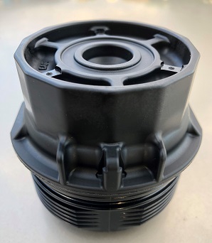

Amazon Sent Counterfeit Oil Filter Cap?
Per the post by [MENTION=165511]damon18[/MENTION], I ordered this oil filter cap, https://www.amazon.com/gp/product/B008BHP68A/ref=oh_aui_detailpage_o01_s00?ie=UTF8&psc=1 Amazon's product image shows what should be an aluminum casting with a drain plug.
I received a resin cap without a drain plug. The box states "Toyota Genuine Parts", however there is no part number printed on the box and no part number embossed on the cap. I'm returning it. Is this item genuine or is it counterfeit? Should I order another one and see if I receive what's shown in the product image? The Dorman oil filter cap sold on Amazon has too many bad reviews. I want what [MENTION=165511]damon18[/MENTION] received.
I ordered the part that you linked and it was a metal housing. The one you show is not correct. Hopefully an exchange will get you the right one. Look also at the directions on here about changing the metal tube from your old housing.
Same here, metal housing in a Toyota box with that part number.

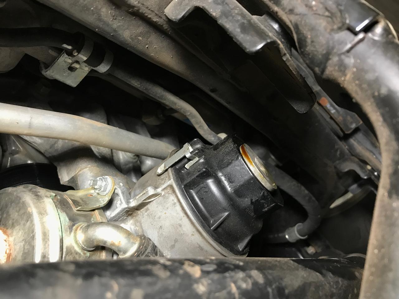

My wife just advised me that she is overdue for an oil change. I have never changed the oil in this vehicle, as we just went past the Toyota Care where we utilized the "free" oil changes from the stealership.
She did wait until we were 500 miles from home to tell me, but no problem at all. Her dad is a farmer, and has 90,000 tools.
Other than a Toyota filter wrench.
Using Google and this thread, it appears that a Pennzoil 19906 will do the trick although there are certainly better brands out there. Given that I'm in a town of 7000 people, O'reilly is the other shop in town and they do have it in stock.
Can anyone confirm that this WILL fit the 4Runner? Lots of threads reference the Pennzoil brand, but not this particular model number.
Also - what is this metal tab on the filter housing?
since you had this free oil changes done then that oil filter cap removal may not unscrew easy.. the auto part stores O rielly have those very soft sockets yes the do fit but if the stealership guy cranked it to the max then that can be a bad day..
read on this posting what filter cap removal tool to get $25 made very solid Motivx name ..
the metal tang on that cap is a position component and does not lock it ..
when you put the cap on the O ring requires replacing and you only tighten it 10ft lbs max.. cap screws on easy then when you feel friction that's it ..
this works for me https://www.amazon.com/Motivx-Tools...ywords=toyota+4runner+oil+filter+wrench&psc=1
I thought so as well at one time. Not the case. See the following thread. Things get interesting at post #14 and go from there:
http://www.toyota-4runner.org/5th-gen-t4rs/188343-dealer-tech-opinion-recent-10k-service.html
IMO I would not trust that tab to keep the cap from coming off ..
when new that tab was lined up with the casting ridge. so when I put it back on that was the same spot the cap got snug ..so I thought like you a position marker.
many do rotate that cap one extra rotation so that tab lines up with that casting ridge then problem removal ..
plastic cap is what I did not like .. I would prefer a metal cap .. plastic will crack over time .
