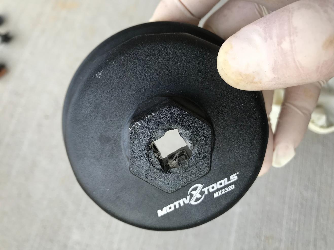

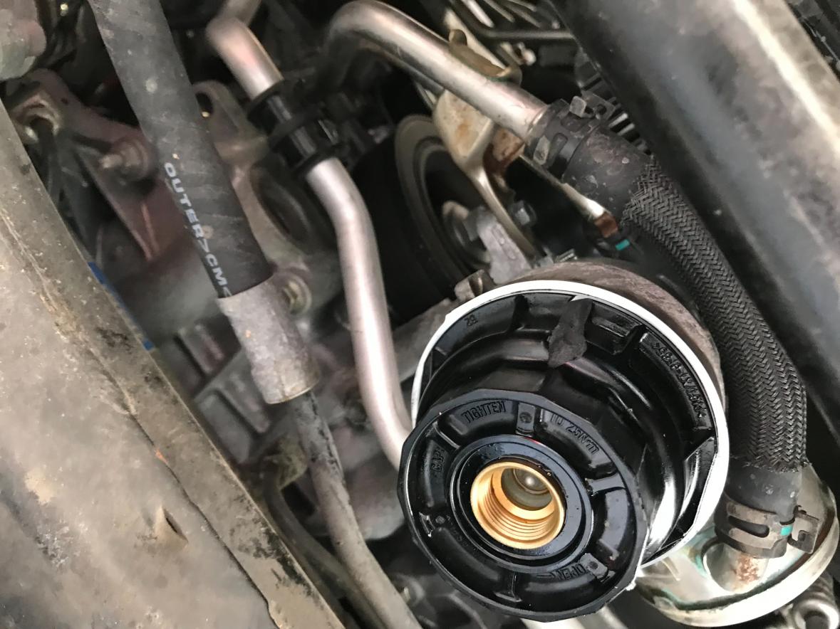

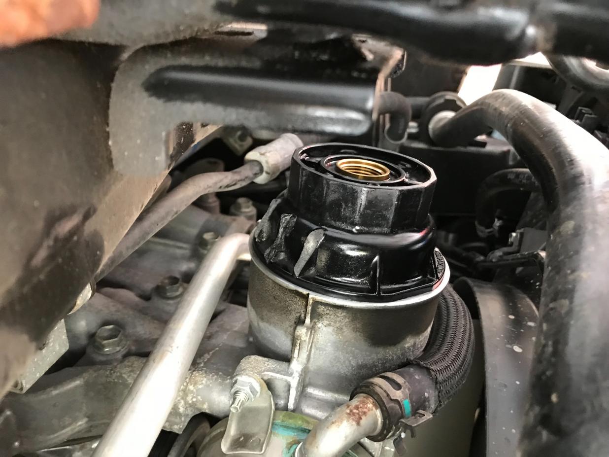

Changed oil of my 2016 SR5 today and it was a mess. Obviously dealer overtightened the oil filter. The metal indicator with the plastic piece was the first one to broke. I used a breaker bar and finally removed the filter. But when I reinstalled it I broke other pieces too... Now the Motivx tool oil filter wrench I used was also also broken in the center area! I did add the new oil in but now how can I replace the new oil filter housing without causing further damage? I could wait for the next oil change but really want to fix it sooner. Saw someone recommended a better filter housing but I’m not sure if it fits better than OEM parts.
Get the metal filter housing. I went through basically the same thing. It is an OEM Toyota housing, same rubber o rings fit, same filters fit. The only thing you have to do is swap the little piece off your plastic filter to the new metal one. I just threw out the plastic housing, and threw out the filter tube insert thing that came preinstalled on the metal one (I think it was shorter).

That one looks good. Did you use the same motivx filter wrench too? I’m concerned I may break it again as the filter cap is still very tight.

I just use a metal filter wrench that has a 1/2 drive spot on it. Something like this, think I got it at Advance Auto

It was the same one that fit the plastic housing. As far as torque goes I just snug it down after hand tightening. 18 ft lbs is probably about right.

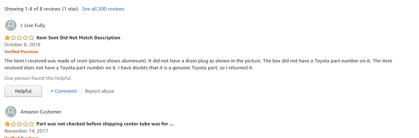

The one you mentioned from Amazon, $20, but some reviewer with low ratings said it's not designed for this 4runner engine so the size is not the same. there's a picture showed it does look different. And it's made of resin, not aluminum.

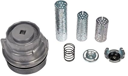

Like I said in the previous post, you need to swap over the filter cartridge stem piece in the middle from your plastic one. Besides that piece, they are identical. The review I think you are talking about, he is referring to the stem in the middle, which is simple to swap (Camry, Tacoma, Tundra, 4runner all use the same housing, but may have different filter heights)
Why do you think it's not alumimum? It definitely is.

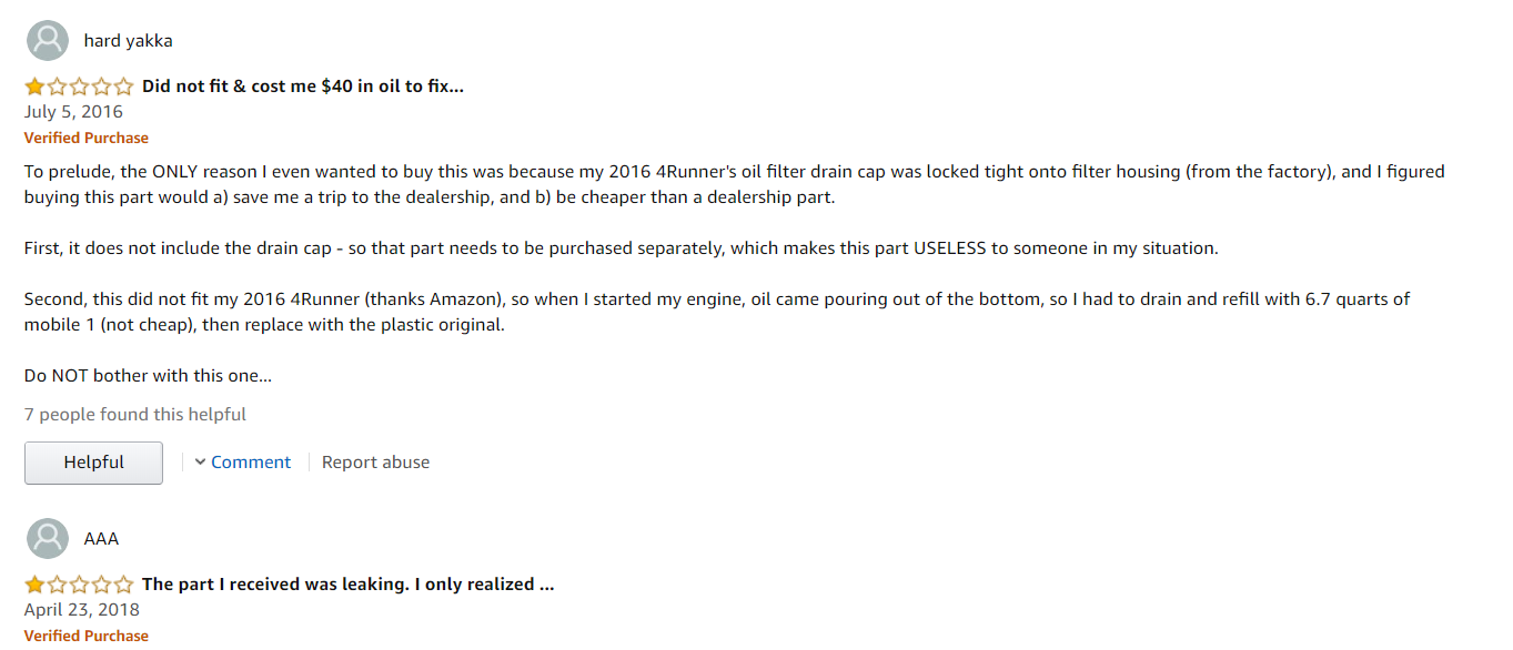

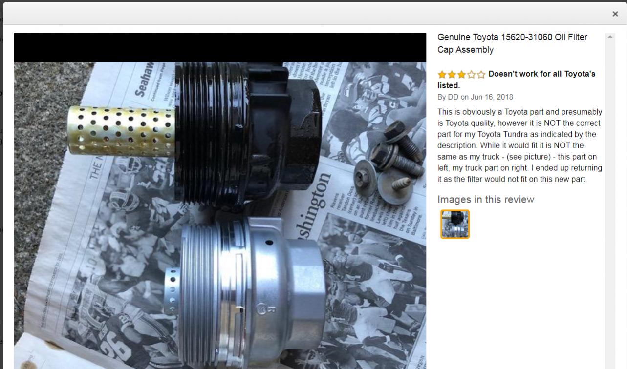

Most reviews are positives. I looked at some low rating reviews and these are what I found. The metal stem is much shorter than the plastic one, would it make any difference in filtering oil or holding the filter tight? The thread part looks a little shorter too.
That is the piece I keep referring to swapping from the plastic one that you currently have. There are just a few tabs holding it in, then you can spin it to remove and swap it over to the new housing. At the end of the day it doesn't matter that it came with a shorter or longer stem in the middle, just use the perfectly fine one you have. Each Toyota vehicle takes different lengths and this metal housing isn't vehicle specific.
I suppose it could come with all the different length ones Toyota uses between Camry, 4runner, Tundra, etc.

Thank you. Just placed an order. Will replace the broken plastic cap with the new metal one. Will waste the new oil and filter that I just put in ...
