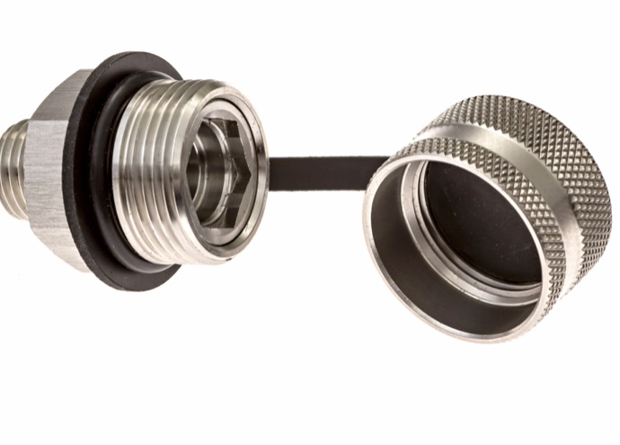

I bought a couple of tools to make oil changes easier and less messy. Instead of a Fumoto valve I got a Valvomax oil draining system. It’s a great looking stainless steel ball valve design. To drain the oil you use a special screw-on adapter that depresses the spring-loaded ball that starts the flow. With an attached drain tube you can drain right into your recycling jug.

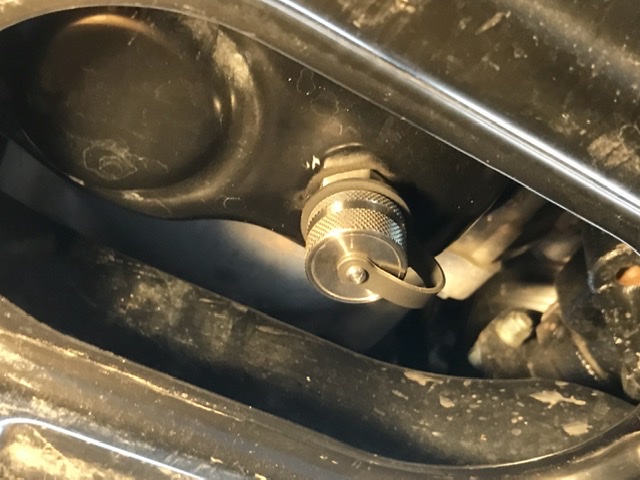

Since I recently had an oil change I needed to do the shop vac trick in order to remove the OEM drain bolt and install the Valvomax without dumping any oil. I was leery of this, so I had my big drain pan ready underneath just in case, but it really works! I took off the drain bolt and the oil stayed in the engine with a high velocity slurping sound. Check out a demo on YouTube:

I’m going to keep an eye on the Valvomax for a few days to make sure it doesn’t leak.

The Valvomax website needs some updates. I emailed them to make sure I ordered the right part for my 2018 4R and the installation torque value. (PN VM12-1.25. To install, remove the external rubber o-ring and dust cap tether, use a deep 24mm socket to torque at 16-18 ft-lbs. Then re-install the o-ring and tether/cap). Also, they supply a metal gasket to use instead of the typical OEM fiber one.

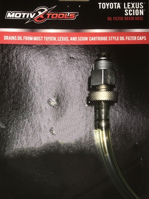

The other tool I got was the Motivx oil filter drain tool. A similar concept, a screw-in device that depresses the spring loaded valve in the oil filter. And an attached poly tube to drain oil into a container.

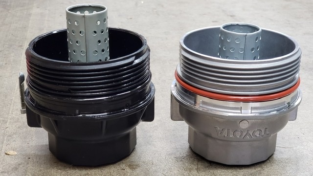

Switched the oil filter cover to metal. Big mistake. Leaked. So I went back to factory plastic.

That’s interesting and disturbing about the metal cover leaking. I have one waiting for my next oil change to install. Did you figure out where the leak was happening? At one of the rubber O-rings? At the cover body to engine interface, or from the drain plug?

For those using the Fumoto valve with the RCI skid, is it easy to reach and engage the release lever on the Fumoto valve with the skid in place?
It was leaking out of the big threads. It is possible that the rubber gasket wasn't good quality as I used the one that came with it rather than the one with the oil filter. I did coat it with oil like I have always done and is recommended so it wasn't an installation problem.
Also, the cylinder that holds the filter in place was lower quality than factory so I used the factory one instead on the metal cover. Of course when I changed back to factory I put the factory cylinder back on.
I bought mine at NAPA. Maybe I just got a bad one. Or plastic is probably better for a good seal.
I always remove my RCI skid plate when changing oil but I'll look and see if opening it will be easy with the skid plate on. I think it should be.

the fumoto valve or the filter canister that was leaking?
I got a metal OEM toyota filter canister that I never got around to replacing the hem plastic filter canister due to laziness...... My plan was to replace the plastic one if I ever damaged it.
yes, it works really well with RCI skids... Its easy to reach and engage.

Fumoto valve is great, no leaks. Leak was coming through the outside threads of the metal filter housing through the big rubber gasket, whatever you call it. Wasn't leaking through the bottom part with the smaller gasket.
Perhaps the OEM Toyota one will work, that is what I should have done. One from NAPA must have been poor quality.

I ordered the metal oil filter housing 15620-31060 from Amazon. It’s an actual OEM part. $23. Swapping the inner perforated tube looks pretty easy. Press down and rotate the tube CCW to remove the short tube. Press down and rotate CW to reinstall the longer tube from your OEM filter housing. It’s even embossed with the torque value 25+\- 5 Nm (18+\-3 ft-lb).

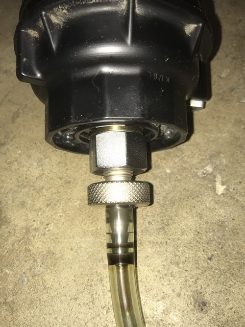

I performed my first oil change using the ValvoMax that I installed a few months ago. I’ve checked on it occasionally to make sure it did not leak. Not a drop.

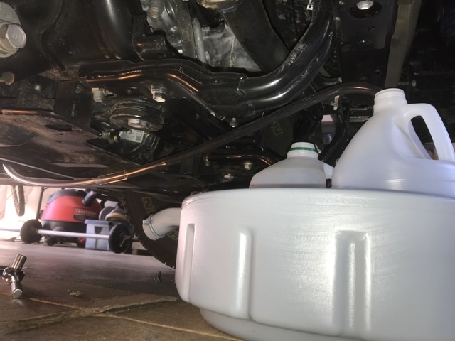

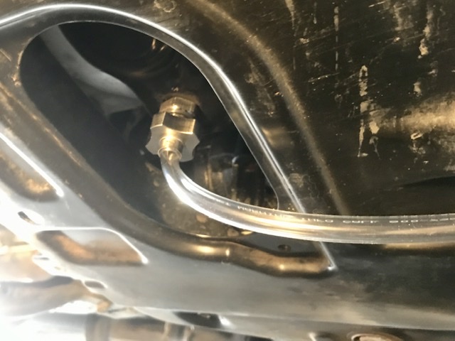

I connected a longer hose to the mating drain tool fitting and drained the oil right into two one-gallon jugs. At stock height and no ramps there’s not much room underneath so I had to position them just right. Due to the small diameter of the ValvoMax the oil drains slowly. After one gallon jug was almost full I pinched the tube and moved it to the second jug for the remaining 2+ quarts.
Using the MotivX oil filter drain tool was a snap. Just screw the fitting into the filter drain and pipe the oil into the gallon jug. No mess and no plastic drain thingy to deal with. However, removing the actual filter housing is a little messy with some drippage, so have a drain bucket and paper towels handy.
After removing and cleaning up the plastic oil filter housing I removed the longer perforated tube and installed it into a new metal filter housing. New filter, new gaskets, and everything fits well.
After refilling the oil I left the skid plate off for a day and made sure there were no leaks around the new filter housing. Looking good!
