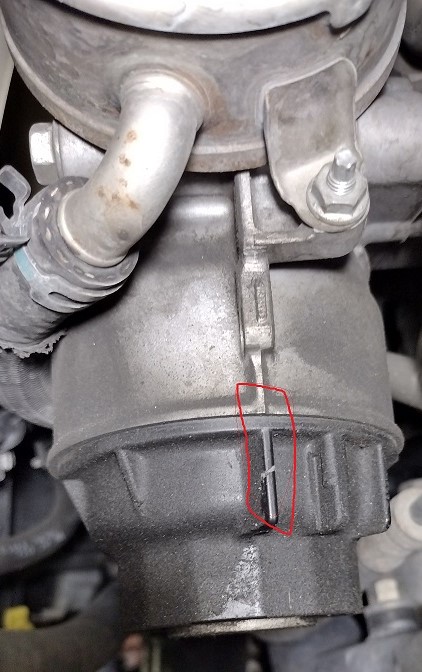

No metal indicator on the filter housing
I didn't have the metal indicator on the filter housing, so I made a nick in the housing that lines up with upper portion
