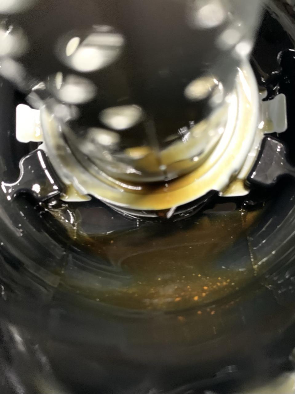

Thanks for the post. I just performed my first oil change at 920 miles using OE Toyota synthetic oil and filter. At this mileage, I knew it was overkill, but glad I did:
1. Found that the factory had not installed a drain plug gasket. Wasn’t leaking, but HOW does this happen?!?
2. Found tiny metal shavings in the filter and at bottom of housing. The filters job is to prevent these from circulating, but happy to get it cleaned out.
Wanted to pass along for anyone considering early oil change or for a reason to do it yourself.

on our new vehicles and do the first oil change some metal particles will be in the engine ... then it goes into the oil filter. normal ..
On my new GM vehicles, I do the oil change at 1000 miles... then the Toyota engines have the same particles .
I did my Toyota oil change at 3,000 miles new .. then I inspected all the drive train fluids and greased the drive shafts and slip yokes...
I had to change the rear diff gear oil ... looked dark and had particles in it .. 3 yrs later last nov the gear oil looks like new..rear diff has a 1500mile breakin ..then change the rear diff gear oil ..many on the forums had to do it..
