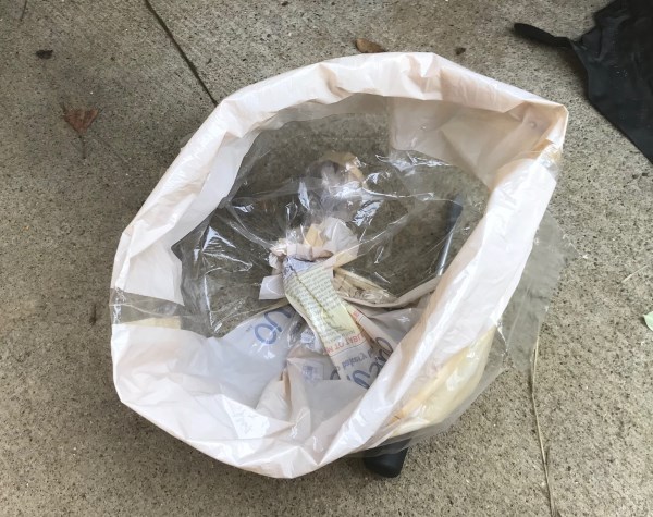

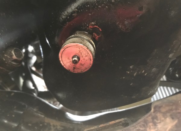

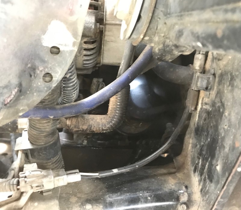

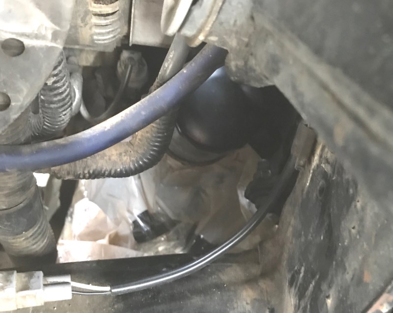

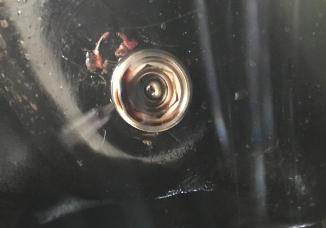

Okay, here are some pics of the oil change.
1st pic shows the plastic bag I used. I did spill some and that was my mistake for not using a bigger bag as I have in the past. I always have cardboard on the ground just in case. Next time I will try the tin oil in addition to the plastic bag to make a better seal.
2nd pic shows the oil filter under the wheel well with the rubber flap open
3rd pic shows the bag under the oil filter
4th & 5th pics show the ValvoMax drain valve. If I had to do it again I would buy the fumoto value, easier to use and less parts. You can see in the last pic oil dripping out so the valve might have issues.
