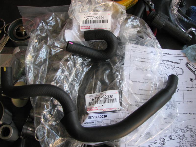

I did them while doing my timing belt. Pretty much got them from the wheel well but I probably got the water pump end from the front since that was opened up at the time. I would go with the OEM hoses. It runs pretty close to the exhaust so all those bends are important I think. Plus I think mine came with an extra layer of hose in certain places for abrasion resistance.
Edit: as you can see from the pic, the longer hose is doubled for 1/2 of the length.
