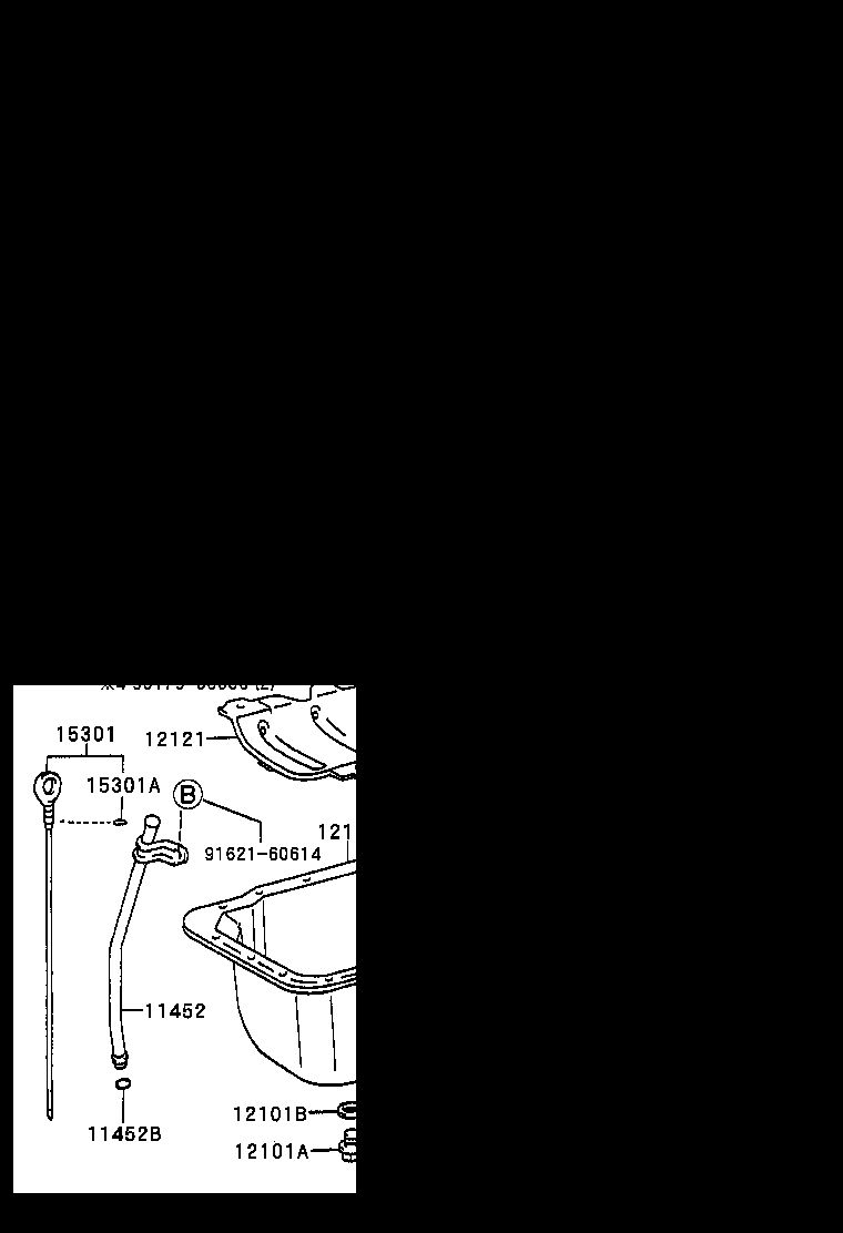

Part# for O ring: 96721-19010
Double check with local dealer..
Thanks! It might be obvious to others, but I should drain the oil before doing this or is the oil level below where that o-ring lives?
The oil would be below the that level, so you probably don't have to.
But if the o ring doesn't come out as a whole piece,
I would definitely change oil then because some pieces of the o ring might have made it into the oil pan and you don't want loose pieces stirring around the oil system..
