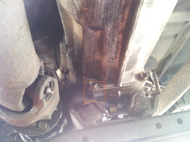

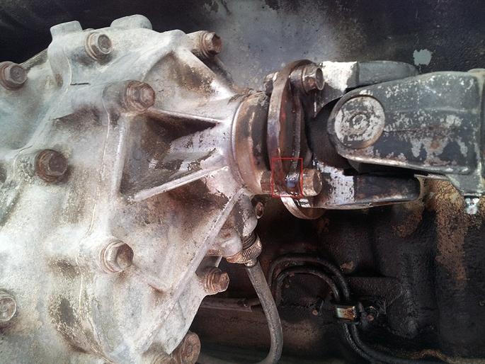

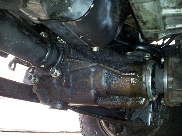

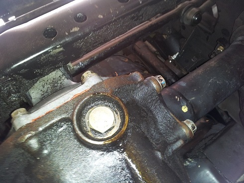

I have oil leaking from a couple of spots. Take a look at the pics. The leaks are coming from the transmission and differential. I believe the front differential is just the drain bolt but it is running down the entire part to the back. The rear diff i am not sure where it is coming from (last pic). Oil is coming by the little hole in the center of the trans. i can push against the plate and see oil squeeze out. Very small amount though.
Would i have to take out the trans to fix the leak or just loosen the bolts and get enough room to clean and seal it?
I will be sealing the oil pan as well.

I think the previous owner put regular oil in the front diff maybe. It feels just like regular motor oil. I will clean it today hopefully.
The rear diff is sticky all above and the sides.
what seal would be in the rear diff? Is it easy to change?
unfortunately no the main differential seal is very complex to do but the pinion seal is not so if its leaking on the driveshaft end your ok but if its leaking around the pumpkin then your in for a battle and if you want to re gear now is the time to do it!
you will have to pull the axle shafts out so do the wheel bearings and all the seals.
the front is not as complex but you will end up pulling the hole thing apart also. i say if your going to fix the leaks anyway youll have it apart so spend the extra 160 and regear for the future.
yes the pinion seal can be done without the pig coming out.
youll need a gear puller to pull the pinion flange off the pinion shaft. its not more then a hour job if you have all the tools.

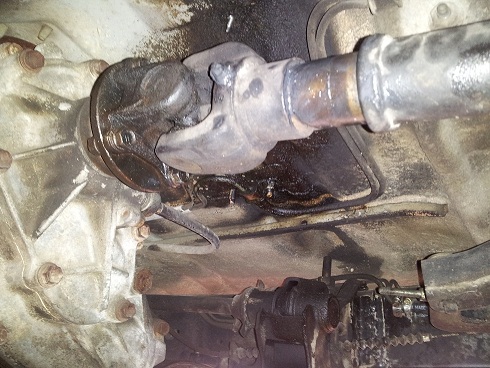

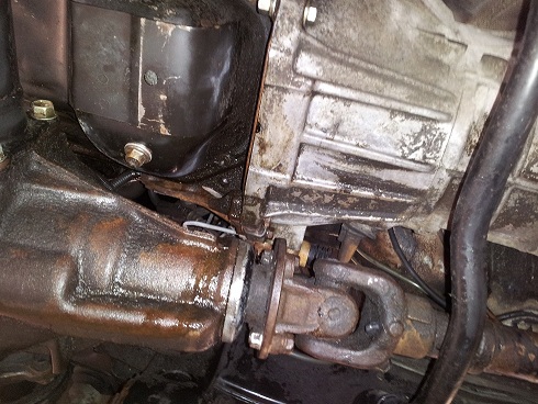

Found the leaks. Oil pan, Rear transfer case to Trans area and rear shaft. I do know how to seal the pan. I cleaned all of the areas and used a rag to seal off each area to isolate the front leak. Thank god it was only the pan.
I didn't realize the rear shaft had a seal. Is it coming from the transfer and dripping out?
Can i just take out the rear transfer to do these seals? Is that a pita?

For the oil pan, go to toyota and order some FIPG. It's about $20 for a tube but it's well worth it. Make sure that your oil pan mount surface is flat. Put a straight edge on the mating surface of the oil pan to make sure that it's flat. If not, get a large piece of steel to lay the mating surface of the oil pan down on. Then get a large flat punch and hammer down on the top of the mating surface of the pan to level it out. Do that all around and your oil pan should be evenly flat and seal nicely against the engine block.
For the transfer case, it's a simple job. I will be doing it to mine soon as well. Download the FSM to see the exact procedures if you're not familiar with it.
in your first picture the location of your red box is not a location that has fluid to hold in now behind the circle flange twordes the transfer case is the output seal that can leak but those bolts you have highlighted do not hold fluid!
