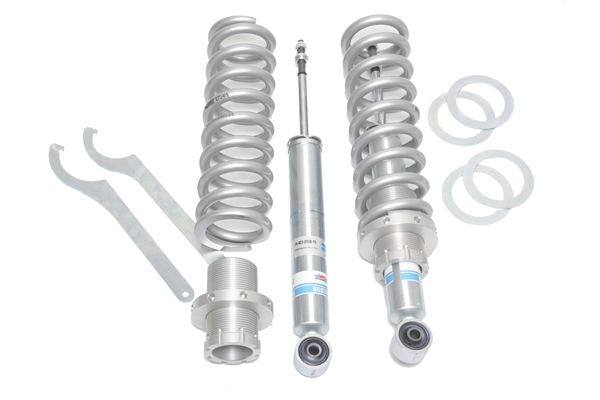

Ok I bought and installed this..
Soooo....How many turns or splins are yall up on the stalk.. im at 23 each side. Now I know I need to measure hub to fender but just wondering bc i have a sprained foot and im tired of laying here and wondering about this!...

that is pretty much where you want to be. I literally just got off the phone with ToyTech and they told me that on average for 3" lift the hub center to fender will be around 23 as the stock is right around 20. I wouldn't go by your "thread count. you should go by your hub to fender. that way you get rid of lean coming from uneven suspension.

an adjustable coilover is an adjustable coilover. the higher you go the more you compress the spring the stiffer it becomes because you are preloading the spring the more you compress it ie the higher you go. (this is even true when using dual and triple rate coilovers. only difference there is your going to compress the softer spring before you compress the harder one) what rate springs are you running??? that also has a lot to do with what you are talking about.

Im running the stock springs that came with the kit which I believe are eibach so.
yep they are Eibach. that is all that toytec uses on their coilovers cause well they are the best. and from what the site says is that they may be 620#. call toytec and talk to them. best way to get it figured out honestly. but 23 in fender to hub center is 3' lift.
