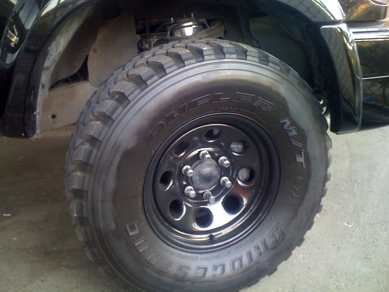

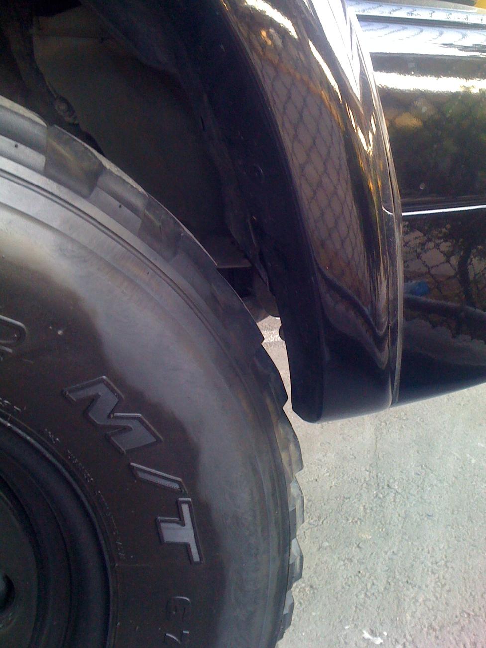

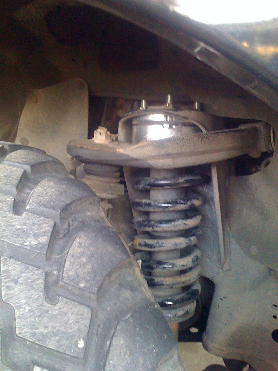

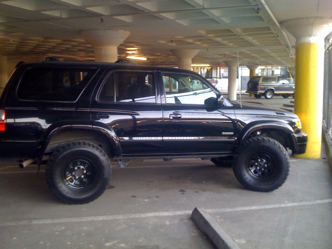

Here are some pictures!!!

Thanks for the pics, although it doesn't look like major rubbing. your pics are very typical of all 3rd gens with 285 tires. Where does it rub again? Im guessing wither the pinch weld, or the frame at full lock and maybe your front bumper too, but not much. Theres not much you can do about the frame, except just not turn as hard, but the pinch weld you can smash flat, and no one would ever know the differance, really! A body lift may help with the pinch weld and the front bumper, but trimming is easier. If you are rubbing on the frame at full lock a body lift wont help at all. IMO your best bet not to rub (without getting smaller tires) is to do some trimming.
I have a 2.5" lift in the front, a heavy winch bumper, and springs with over 200k so I know what you mean about the rubbing; and I did rub at the pinch weld before I smashed it flat, and on my stock bumper too (trimmed it as well) and I still rub a little on the frame at full lock, but that is mainly when I'm off road.
Thank you, its definitely NOT a pinch weld or frame, Its just that corner of the bumper. Its not horrible, BUT it sounds really bad. If I am going downhill, turning at higher speeds, or braking while turning...anything that causes the front to dive a little!
Going to keep my eye out for 99 front coils with low miles as well. i think I do have some sag, as mentioned before.

yeah, pretty sure the rake you got is a little extreme due to the front coils. you put some better coils and it wont dive as much and your prob will be solved. mine did the same thing on bad coils with 2.5 inch poly spacers. I prob only had 1" of true lift cuz of that. Body lift isnt a bad idea, but not entirely positive that you will need it. try putting some fresh 99 talls in there and see if that doesnt clear your tires enough.

Aside from the rubbing, which can be fixed.....your rig looks sweet with the lift! I'm always partial to a BLACK TRUCK!
I have the same problem, minor trimming cured daily driving but it's the rake. I am going to add a 3/4 to 1" spacer to the top of my 881's which will level it out then I will be adding a 1 - 1.5" BL to cover the rub while 4wheeling. Spacers with stock springs just don't cut it. After being on this forum and viewing what everyone else has and has done I would recommend either OME 882's or adjustable coil-overs when running 285's.
