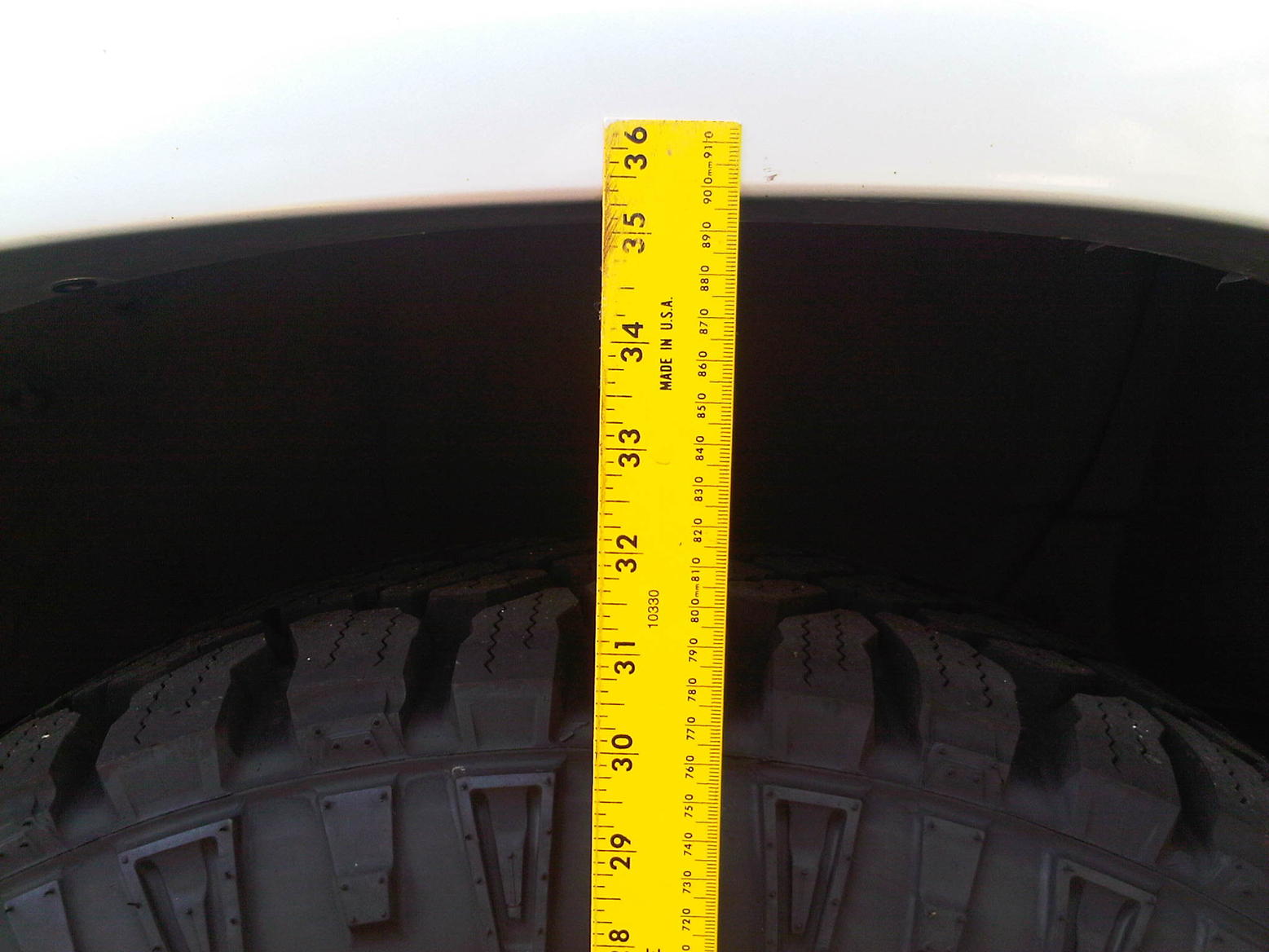

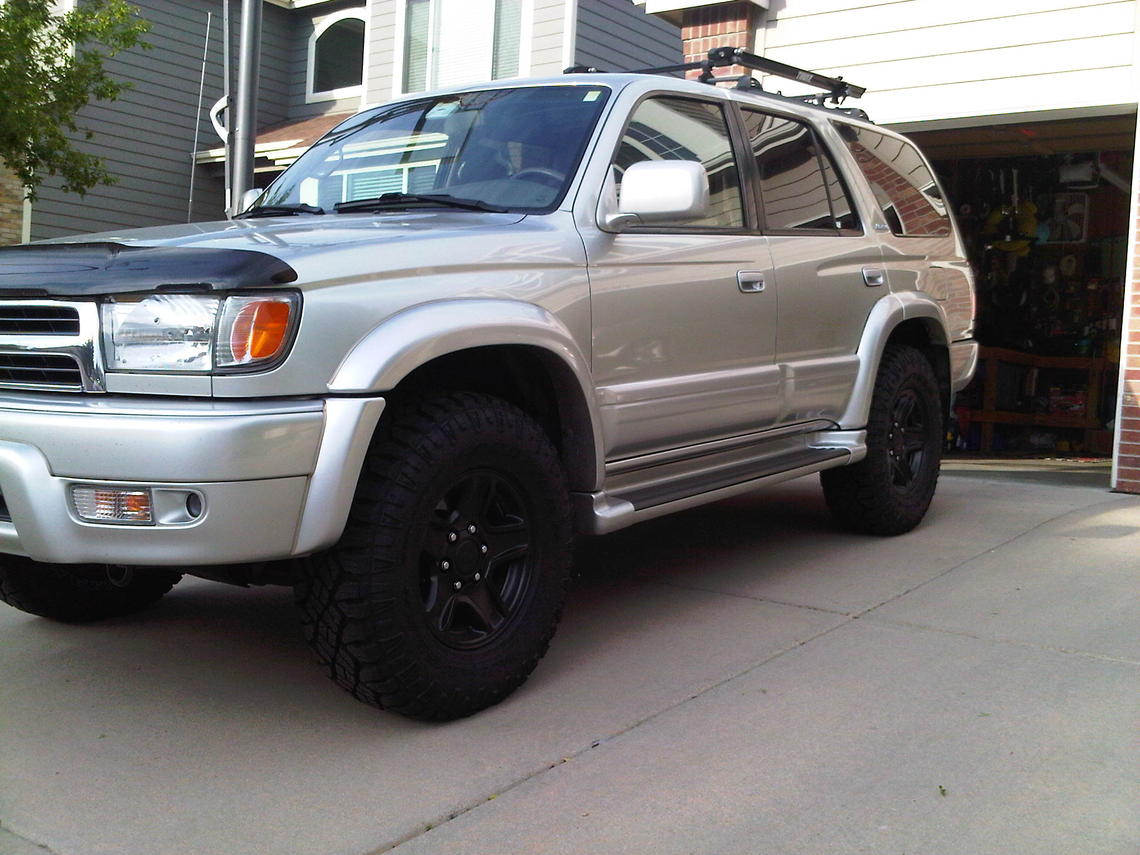

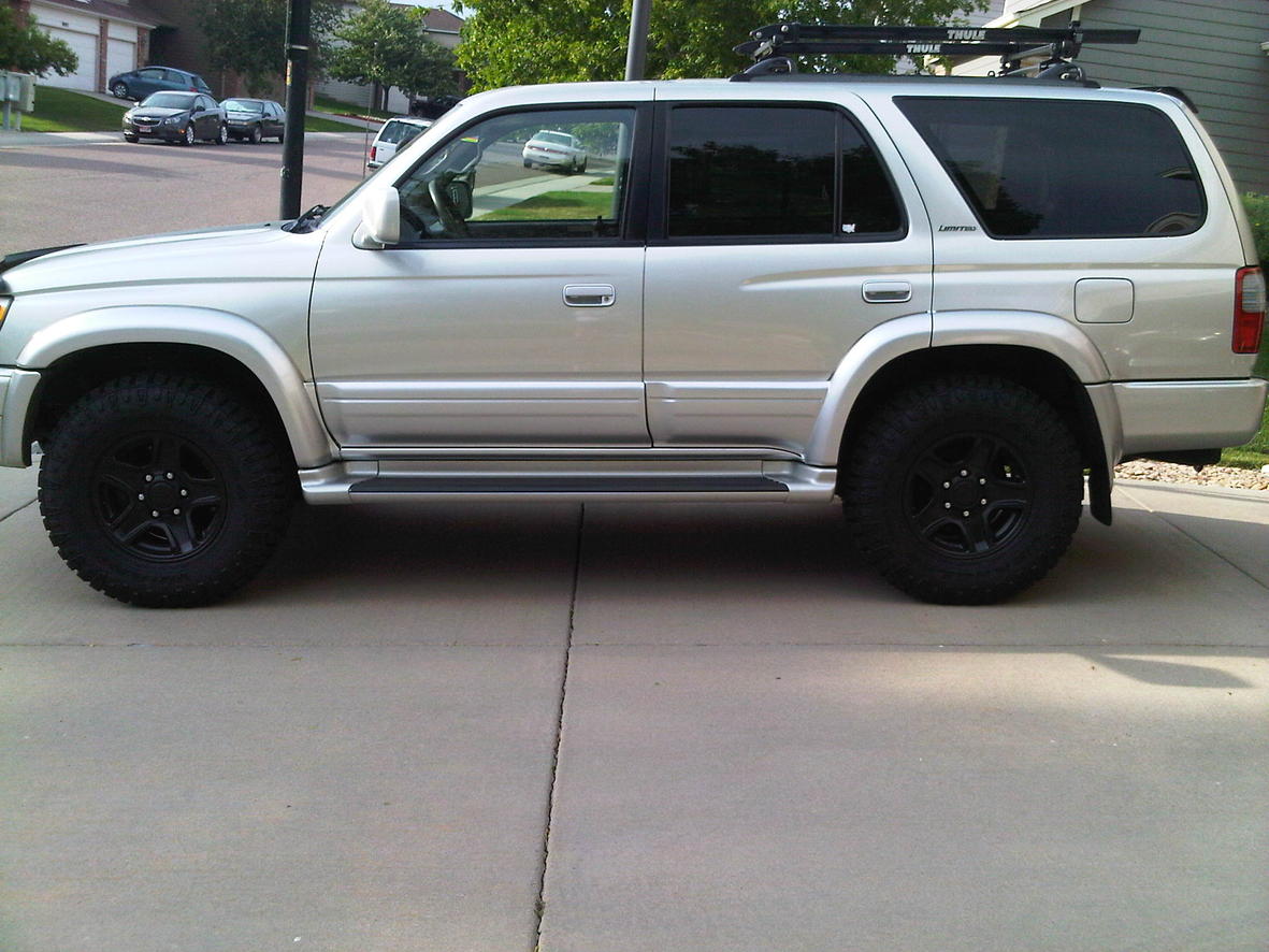

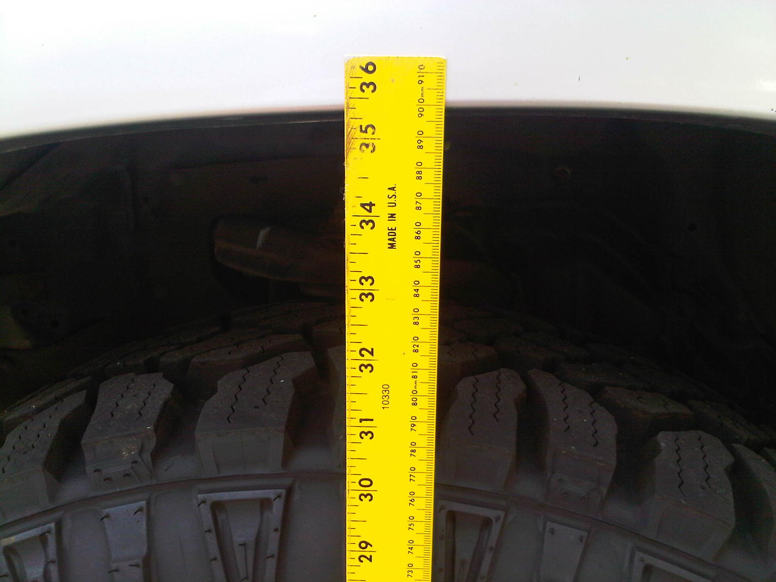

Background: 4Runner is a 99 Limited with tall springs. Running 265/75/16 Goodyear Duratracs. I'm sitting just shy of 35.5" right now. My current springs are pretty old and tired.
The bad: I blew one of my original shocks in the rear last week. Rig has 140,000 miles on it. Time to upgrade.
The requirements: Minimal lift. I don't want my tires (which are new) to look small by lifting too high. I would also like to avoid a diff drop, or new panhard bar etc.
I am dizzy looking at options. I have a wife and two kids as well, so I don't want to go too big. Here are some pics of my setup now. If I could gain 1.5-2.25" that would be IDEAL. Anything closer to 3" is too much IMO.

I'll give you two opinions.
First, when my 96 limited was stock on 265/70/16s it rode at the same height. Not really an opinion I guess! :)
Second, get adjustable fronts and throw wildly at the rear. 906, 890. Doesn't matter, you can always adjust the front to match, then if you wantto change it in the future you're only out one set of rear springs.
In the end, your ride will look fine either way.

Now leaning towards 881/890 combo.... just nervous that (3") in the rear will be a bit much. Keep in mind I am only sitting 35.5" from ground on all corners now... so obviously my 99 coils have sagged. BTW, that is with brand new 265/75/16 Duratracs.

I’m running 265/70 R16s. All four corners are at 36 inches from the ground dead center of the wheel to the bottom of the wheel well. There is a gap of seven inches from the bottom of the wheel well to the top of the tire. Rides like a champ now.
