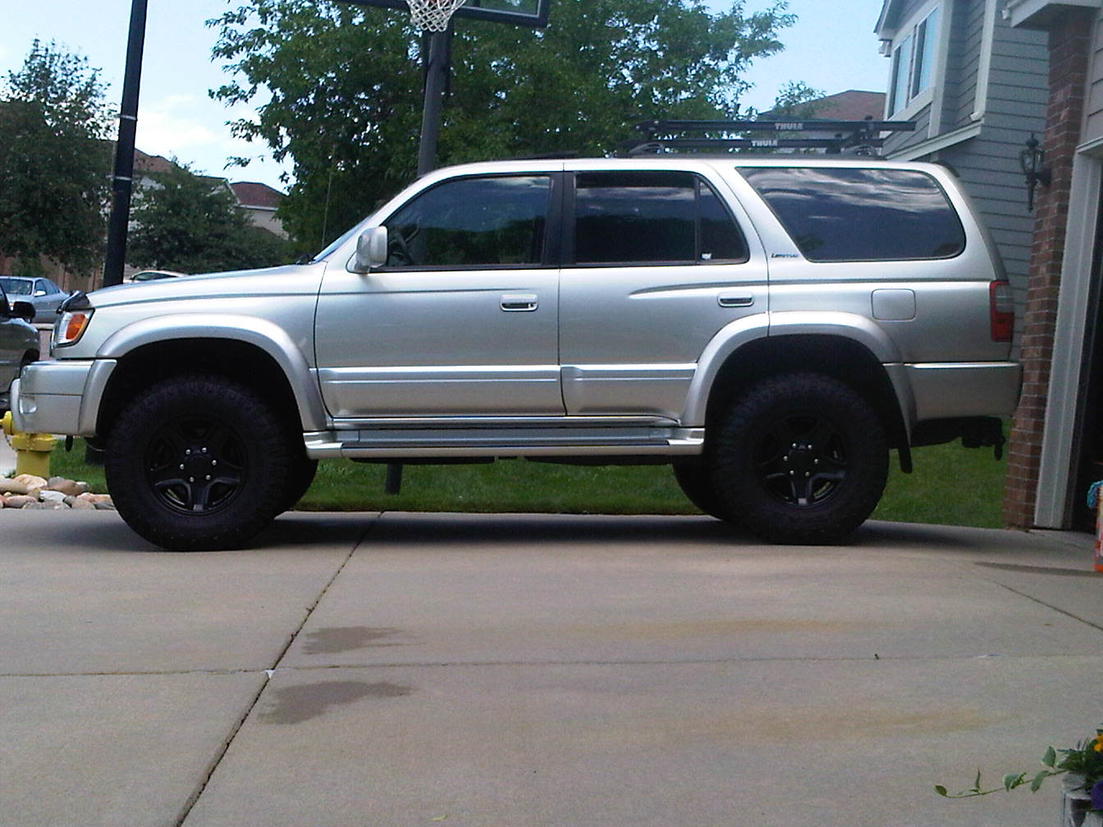

As I promised:
Before: Stock 98 suspension @ 250,000 kms, no spare tire, no hitch
After: Rear - OME 890 coils (w/rubber cones in), OME 60028 rear shocks
Front - OME 881 coils (NO top plate spacers), OME N91C shocks
Spare tire mounted underneath weighs ~90lbs, still no hitch
It does have rake. BUT I would rather it like this so it sits level when I add 200-300lbs and go camping/wheeling. I still may remove the rear rubber cones to lower the rear by ~.5inch
The trucks stance is really good and the rake IMO is perfect. The only thing you may find if you remove the rubber cone is that the springs will move and rattle, and the metal to metal contact can be annoying too!:thumb3:
Never thought about that. Thanks for the input. I may be just leaving them "as-is" then!

Ok, as promised... here is a quick pic of the final product. My driveway makes the stance look a tad deceiving... it has a mild rake, but the pic almost makes it look level. I did NOT do spacers in the front. Again, this is the 881 coils up front with 890 rear. Enjoy!
hmmm this setup looks framiliar! haha looks great man. I have wheeled mine 4 times now with the lift and I am loving the suspension setup. The rake is perfect because it sits level when it's loaded up and it Flex's great! (my sway bars were eliminated upon lift install, so that does help some but...)
