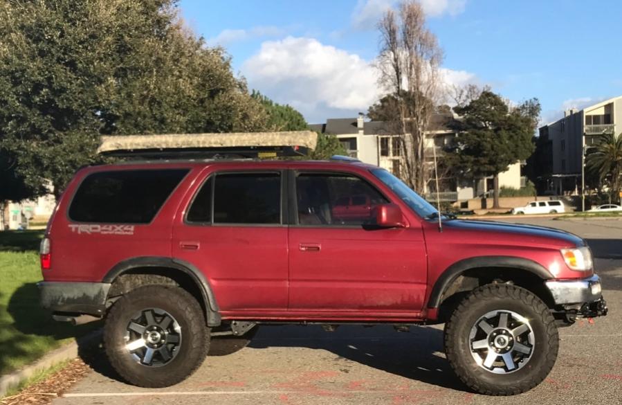

Here is mine with the 880/906 combo and 5mm trim packer with the wheelers 4Runner Bilstein 5100s. It has about .5 inch of take after settling for 9+ months. Rides nicely too.

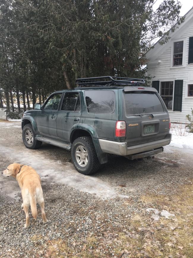

I have ran the 881/906 with OME shocks for the past year and a half. It sits with just a bit of rake but I did install 1 trim packer per side. Photo is with 31" tires for reference. The 906s are fairly stiff and did settle a bit for me. They handled additional weight quite well when loaded up. Fairly difficult to address what too high is without a photo or hub measurement. Personally like the look with a little rake but to each their own.
Your sig says you have 881/890 springs. Compared to all the pics I've seen of 906 springs they give you a very subtle lift in the rear even when new. The pic your showing really looks like a 3" lift like the 890s provide. Could you clarify?
The photo above was running the 881/906 before I put on 265s. This did include one OME trim packer per side. I ran that setup for well over a year and just put on the with the 890s and new wheels/tires the past few months. Photo of the current stance with 881/890s 4" bs steels and 265 Milestar Patagonia M/T.
