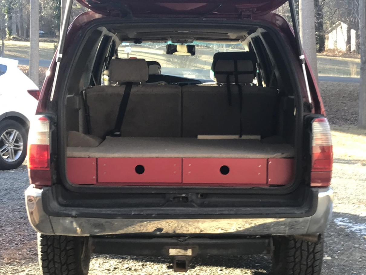

Build a drawer system to help dampen the rear !
