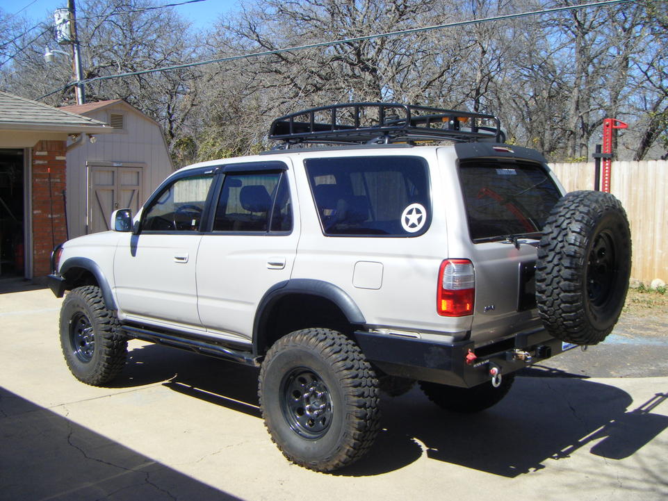

Though I might this pic into this thread for anyone who's interested. A couple of people have pm'ed me asking about my vehicle ride height.
Tundra coils up front, 890's out back. OME shocks all round. Car is parked on a slight downward slope towards the rear and has about 100 lbs in the cargo area and has a near empty fuel tank.

nice shot techno - not sure I have seen photos of your ride.
If you look at just the two posts above me you can see that the whole lift issue is pretty confusing . The choices are overwhelming and some folks even go Crusier fronts to rears and vice versa! okay maybe not
techno you seem to have a heck of lot of rear lift for just 890s. What are those some super duper OME testers or what! just kidding dude it must be that downward slope of the lot contributing a trick of the eye.
I have 891s and my rear sits no higher-I do have some rake .
