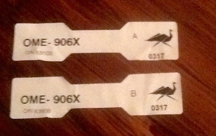

Can you post a picture of what this looks like? My 2906 springs were labeled 906X on both and even on the box. It sits near level in the rear. 1/4" higher on passenger side.
These were the labels attached to each coil. Notice the A and B on the right side or the labels. I couldn't notice one taller than the other just looking at them. The tech I talked to at ARB did mention that A could be stiffer than B possibly.

Well shoot. I wish they coils were identified with paint or something permanent. I pulled the tags off and installed them before i realized they were side specific.
well shit.... i didn't pull the whole tag off so i didn't see this! Gosh I hope it did it right because I just wasted 2 hours today swapping from left to right lol....still same lean!
Weirdly.... my 880 front springs don't have A/B on them. I just pulled the sticker and found nothing...going to look at my 906 in the rear and see if I set those right. I have a feeling they are on wrong...
Confirmed my 906 are installed reversed...ugh. Time to flip them later today.

How did you know they were wrong, measuring the height in the rear corners?
I left the stickers on the springs due to laziness. I pulled one off and confirmed it was wrong.
Also the car wasn't level in back. I was 36" driver and 36 1/4" passenger with half gas. Now I'm 36 1/8" on both sides.
My front seems better now too. Only about 3/8" off now which was how the stock springs were too. Driver side lower.
