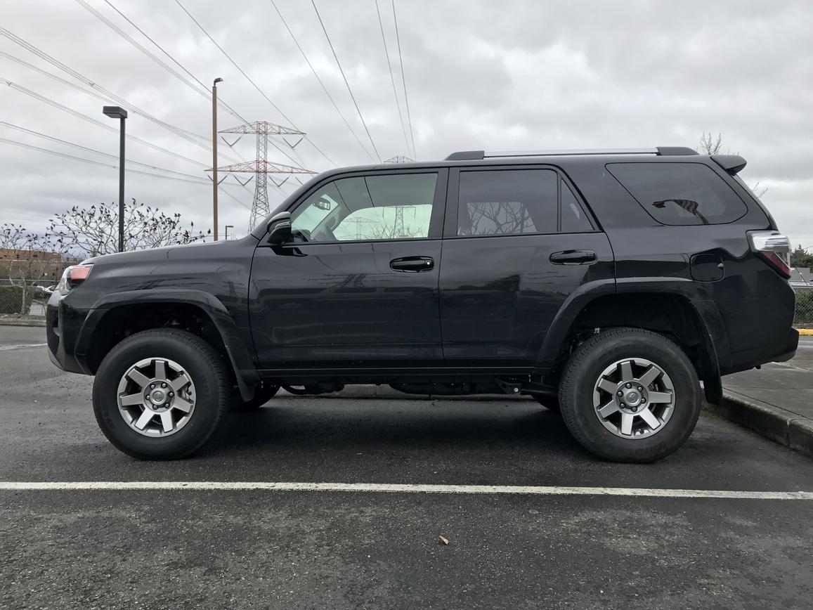

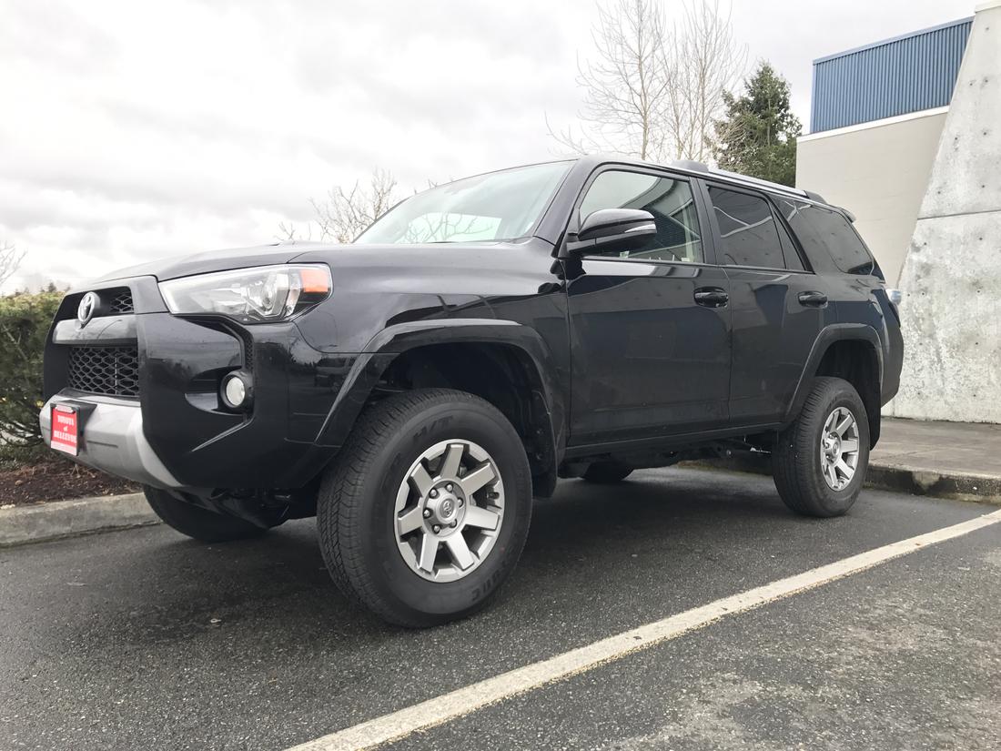

I was the guinea pig to have the BP51 OME kit test fit on my 2016 Trail w/ KDSS. ARB USA is local and I was fortunate that my dealership hooked me up. It's a 3" lift but sits with a slight rake for now. I will have it leveled when I pick up a new set of shoes.
hey all im new to the forum .
I was the guinea pig to have the bp51 ome kit test fit on my 2016 trail w/ kdss. Arb usa is local and i was fortunate that my dealership hooked me up. It's a 3" lift but sits with a slight rake for now. I will have it leveled when i pick up a new set of shoes.
pics or lies!!!
Hey all im new to the forum ��.
:suspicious: Not sure what drugs you are on, but you're definitely not the guinea pig. it's already been done multiple times.
Lol , the reason why I don't interact on forums.
Anyways I was told that ARB wanted to test fit "brackets" specific to the 5th gen KDSS before officially releasing it. Maybe I was misinformed or misunderstood. Regardless I got a killer deal.
I will try to have pics up tonight. I just picked her up yesterday.
EDIT: Also it was installed and aligned with stock UCAs

Yes, please post pics and any details. I'm slated to get the FJ kit installed on Monday -- although if they're still just test-fitting then an actual production release is probably still a ways out anyway.
I was under the impression that installing it on my rig was the last step before releasing it. OME and ARB communicated throughout the install and test, for about a week. You should definitely contact them to verify. I heard all this 3rd party from the dealership.

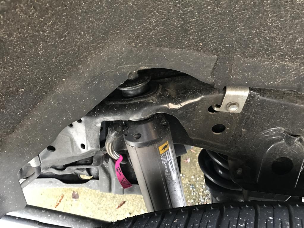

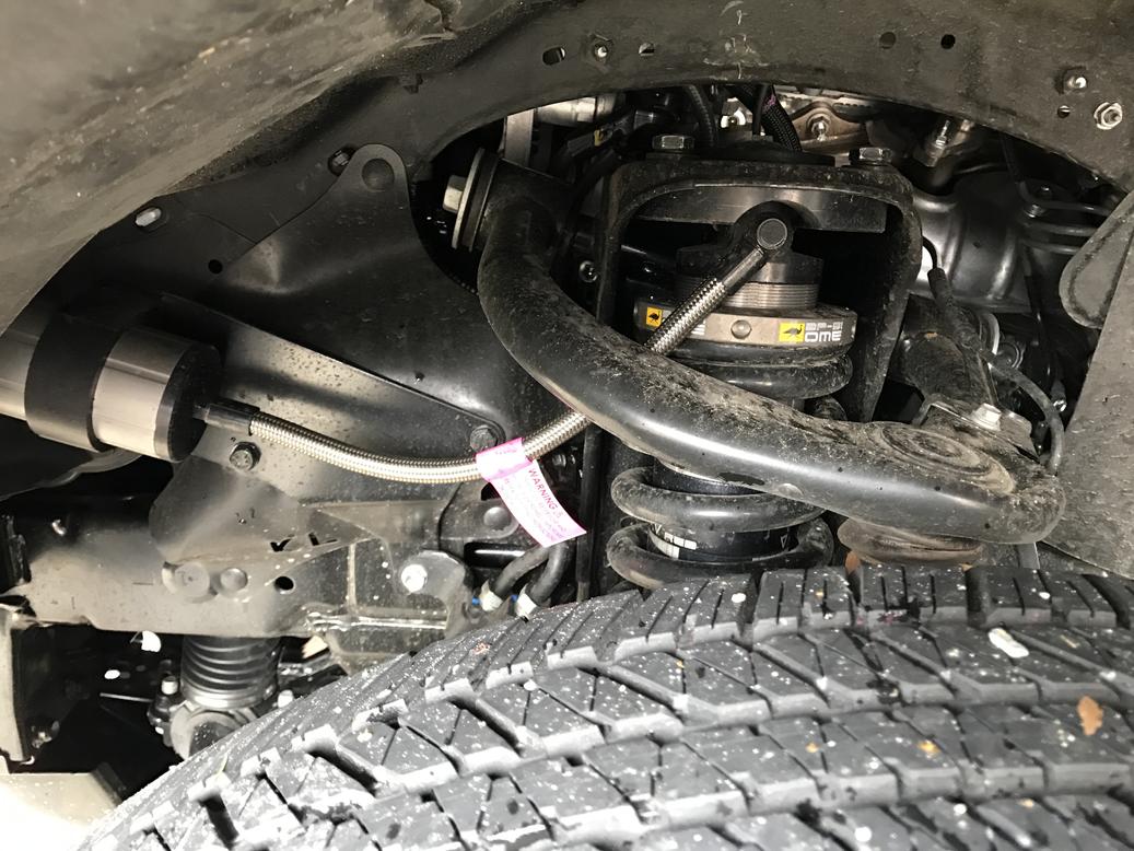

Here's a few shots

Good stuff.
This is definitely a new bracket. Strange that the dealer(?) didn't install the reservoir behind the fender liner.
Now the real question: are the struts a different part number than the FJ kit (I.e., different valving and/or C/O spring rates) or just different brackets?
