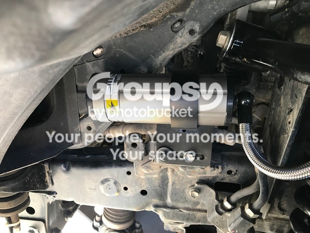

[MENTION=117003]Lava rocks[/MENTION] had asked for shots of the preload and reservoir bracket. You can see they dialed the preload way back.
2017-02-17%2012.45.27_zpshmnovgbv.jpg~original
2017-02-17%2012.45.21_zpskdfzgmip.jpg~original
Where it is right now gave me 2 1/4". That was how Slee set it up and I have been debating on whether I should see if they'll increase it or if it's worth it.

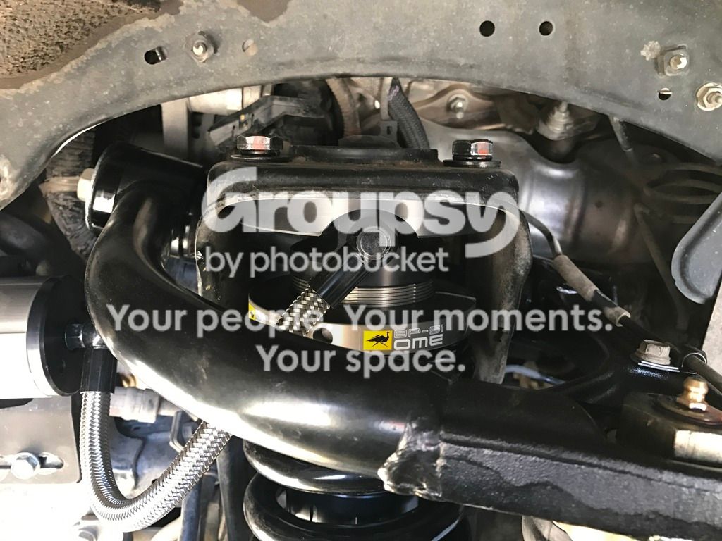

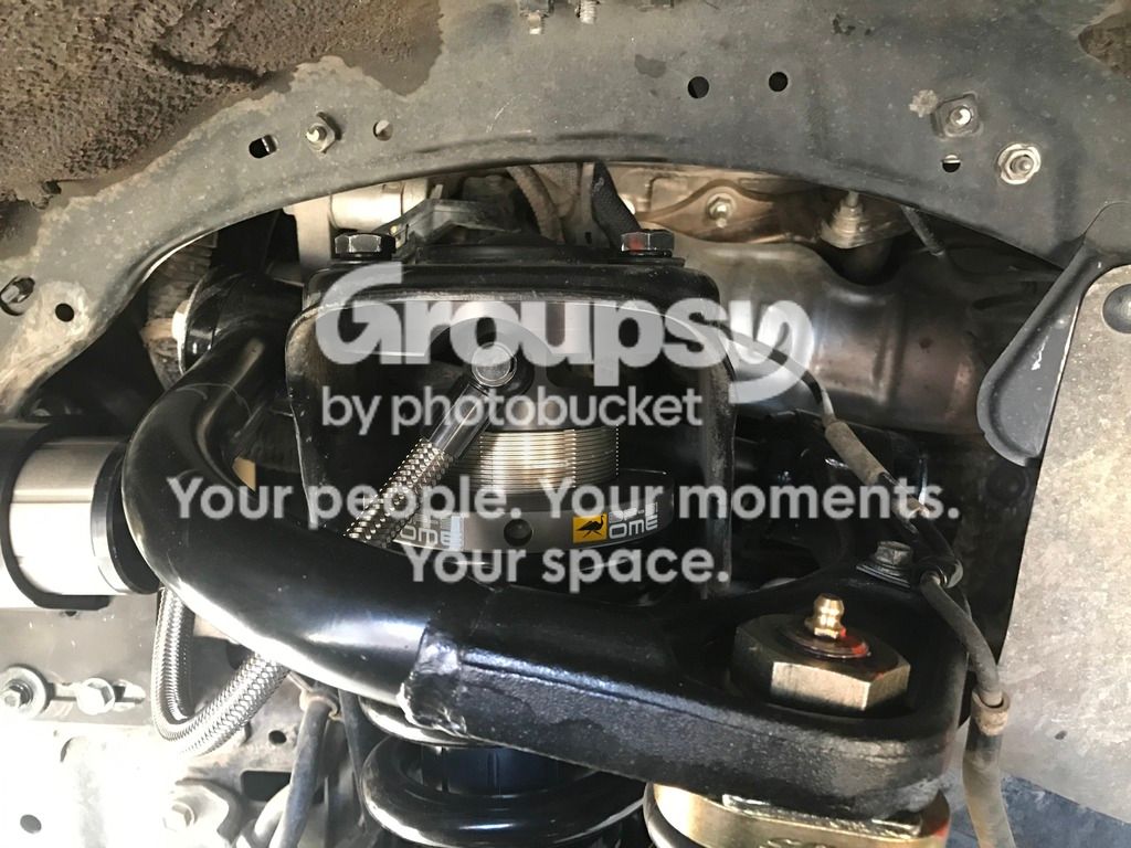

Oh, I posted these in my build thread, but I did have Slee adjust the height. I got another inch up front which restores my rake from my numbers before the bumper, winch, and lift; just up 3" higher.
Final numbers:
22 3/8" front
23 5/8" rear
2017-02-21%2017.31.58-1_zpsbruekzvg.jpg~original
Current preload with the witness marks from the previous setting.
