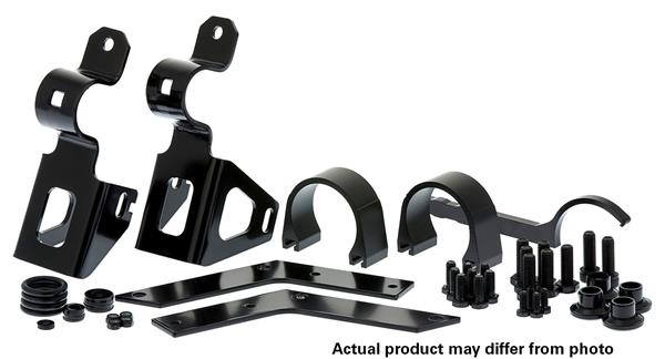

Until recently, the OME BP-51's were designed for the FJ Cruiser. Yet, many were installing on 5th Gen 4Runners.
OME now has 2 kits for the 5th Gen 4Runner, Non-KDSS;
Part #OME4RNR10HKBP51 - Heavy Load Kit - Click Here
Part #OME4RNR10MKBP51 - Medium Load Kit - Click Here

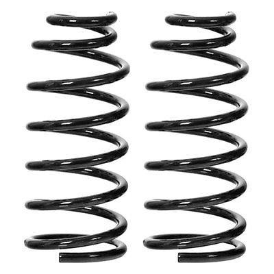

I'm looking for ~2.5" of lift in the front and 2" in the rear (889 OME Coils) and will be runnign 275/70 KO2 on the stock TRD Off Road wheels. The weight on the front and rear is stock at the moment; however, I will be adding skids and sliders down the road.

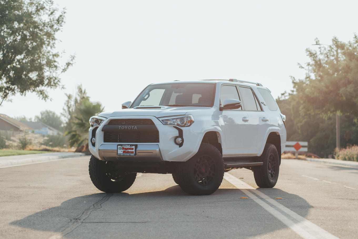

Finally installed them this weekend. What’s everyone’s settings?
