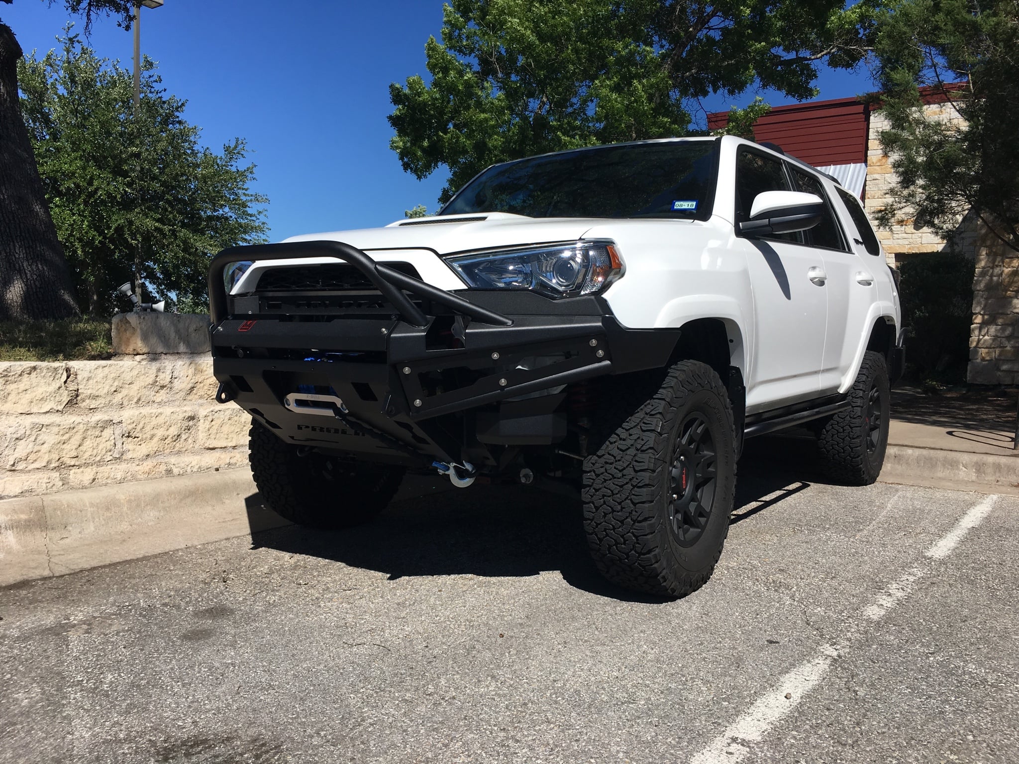

Loving that front bumper,,like to see some different angles,,sweet rig Giz!
Dang, looking pretty well level there The Giz! What's your preload at?
I agree it does look level there but will settled slightly. I'm at the factory set 20mm preload with 130lbs bumper and 70-80lbs winch.

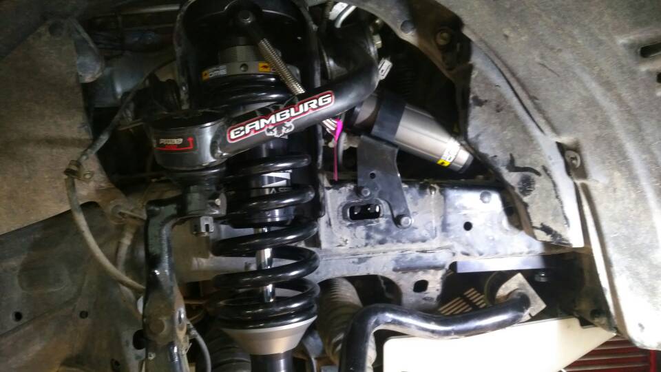

The sway bar clearance issue exists for me. I have the 5th Gen BP51's. It seems my sway bar droops down more on the driver side, and its rubbing the radiator bracket where you add the radiator spacers. The passenger side of the sway bar has perfect clearance, its the driver side that has the issue. Going to call tomorrow to see what my options are. I also don't like the rear reservoir line being so close to the metal frame, ill take a pic of it tomorrow to show you what i am talking about.
I'm going from a 2016 TRD Pro Bilstein Shock with Toytec TRDPro 2" Spacer lift with rear Superflex Coils to the 5th Gen BP-51. The ride difference is night and day on the street and highway. No leaning, No nosediving, Stiffer, but not too stiff where its uncomfortable/jerky. Handles the weight much better. I'm happy, but need to get this sway bar issue resolved. [MENTION=134058]Midnight Anvil[/MENTION] any ideas?
Do you have any kind of a sway bar drop? When I did [MENTION=128083]The Giz[/MENTION] 's install we also did Total Chaos upper control arms but I can't remember if it was the OMEs or the UCAs that included the drop kit. Didn't seem to have any clearance issues.
Do you have any kind of a sway bar drop? When I did @the_giz 's install we also did Total Chaos upper control arms but I can't remember if it was the OMEs or the UCAs that included the drop kit. Didn't seem to have any clearance issues.
I'm running Camburg UCA.
