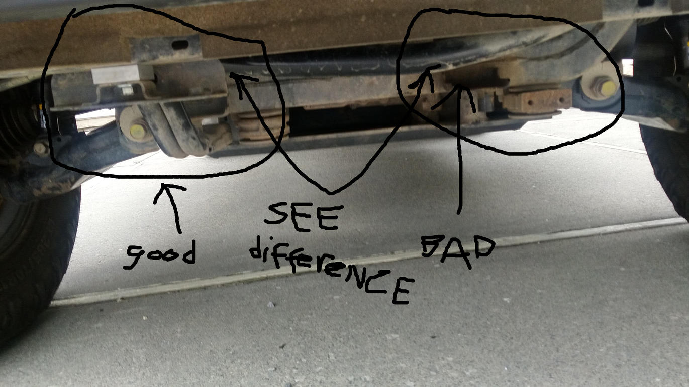

See how the sway bar comes down on the right side.
@Midnight Anvil

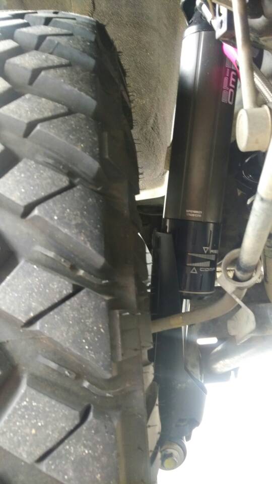

Also, Is it OK for the rear reservoir line to be so close to the frame? Look to the right of the pink tag. I put a piece of rubber in between so it don’t rub.
Sent from my STH100-1 using Tapatalk
I just moved the reservoirs back and forth in the bracket until I found a comfortable spot with enough clearance. As for the swap bar, mine was fine once I installed the sway bar and radiator relocation kits that came with the lift.

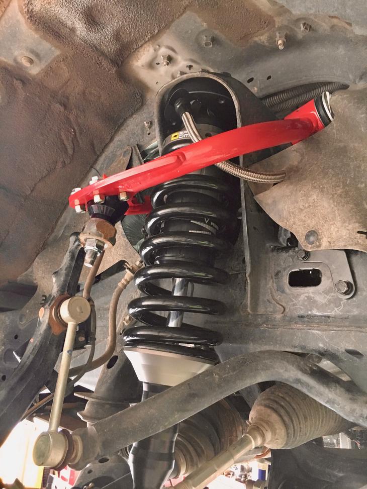

OME BP-51 with JBA UCA installed

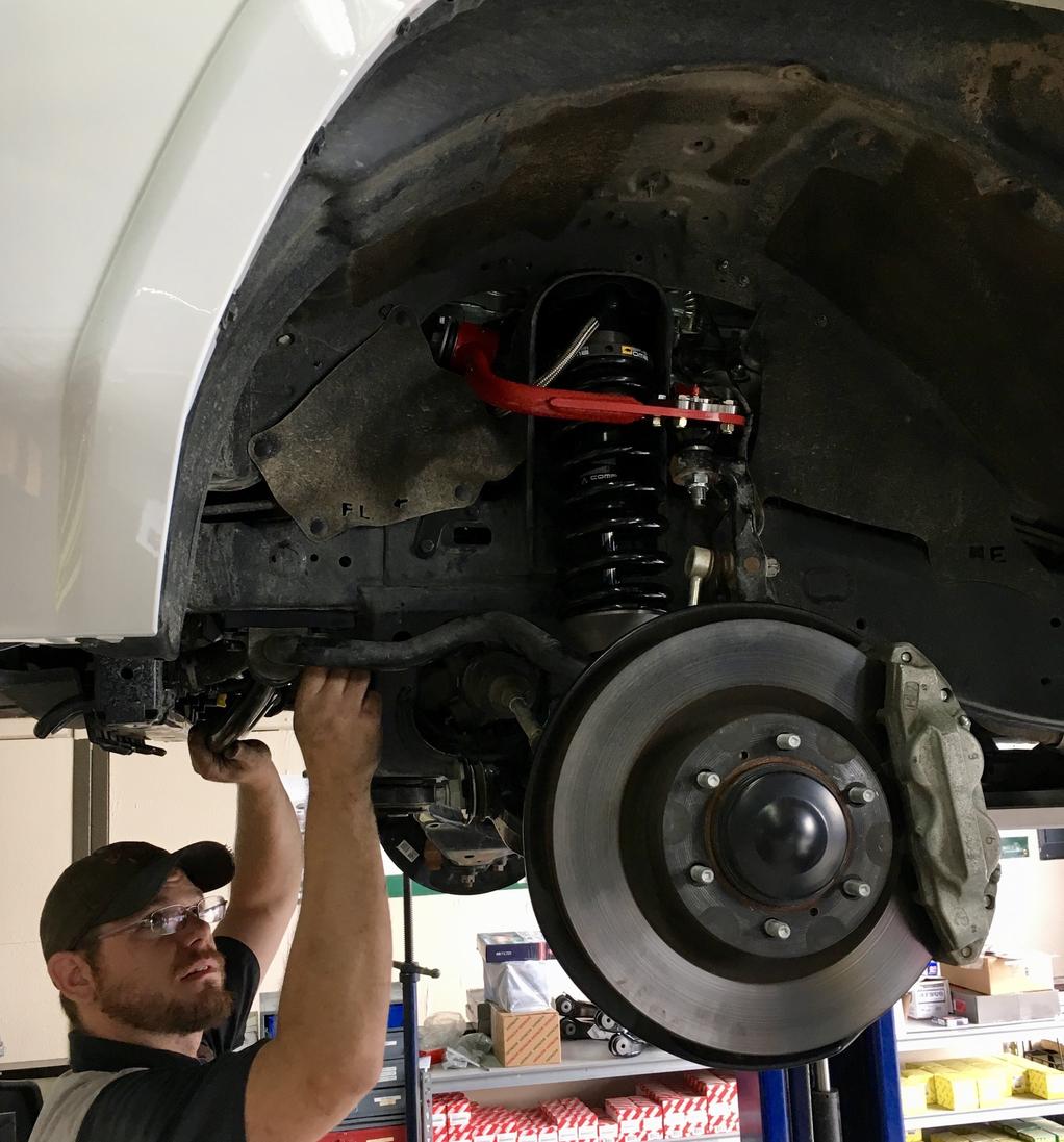

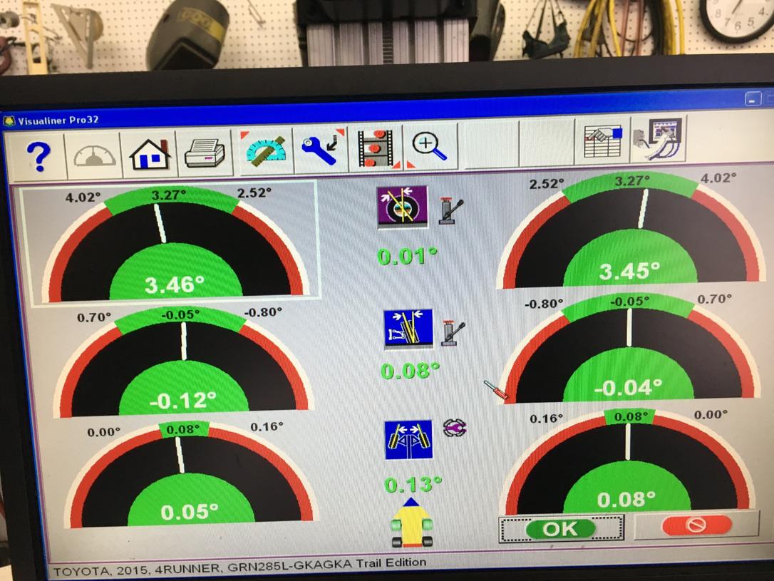

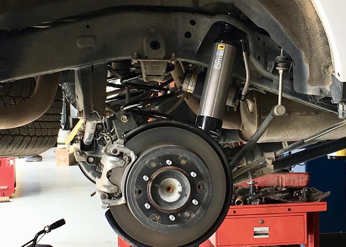

OK - I did a lot of research and hope that I made the right decisions. Marlin and his team just sent me my new JBA UCA's to be installed with the BP-51 suspension that came from ToyTec. I am trying to set up a new Overlanding rig for trail use and mild crawling and will be installing these components this week. As both these items (UCA and BP-51) seem to be in the minority of items selected for our T4R's throughout this and other forums, I would be happy to answer questions and give feedback to anyone interested in how these components work to improve the ride and off-road abilities of an already great 4-wheel drive.
:banana::boxer:
Epilog
I had my OME BP-51 suspension installed along with new JBA UCA's on my 2016 Trail Premium T4R. The install, with breaks and the follow-up alignment, took about 8 hours. It was straight forward, though the instructions (still only FJ/Prada) were a little confusing at times for the brackets. The included sway bar and radiator relocations kits all fit with no issues. The kit did not come with a spanner wrench so I could not adjust the coil over preload and left it at 20mm. In the end, it worked out fine as the lift ended up about 3.75 in the rear and 3.25 in the front. You cannot visually see the rake, and the T4R looks level, so I was happy with the results. As for the Compression and Rebound settings, after talking with David at ToyTec, I set the front C at 2 and R at 5 and the rear was C at 2 and R at 4 as I used the OME 889 medium springs. His recommendation for a rig with mild weight (sliders and skids) was C at 1-4 and R at 4-8. I went on the lighter side, and the ride is good for a lifted vehicle. The ride is firm but not harsh. Gone is the body sway on turns and the hood bob when breaking. Bumps are felt but not as harsh on rough roads as pre-lift and handling is tighter and improved at highway speeds (75 mph as it is Colorado). The JBA UCA's work great with this lift and the alignment came in great after a few readjustments after the installation. (See the pictures) Respond if you have any questions and I will see if I can give you the answers.

good to know that you got it to work without sway bar rub. i have jba arms and putting in the bp-51 soon.
You cannot adjust the ride height unless you have this in a spring compressor. BP-51 cannot be adjusted while under load.
Understood - I have one at the shop but not the right diameter spanner wrench to fit the shock body. I am glad anyway as the T4R seems pretty level and if I reduced the front from 20 mm to 12mm as planned, I probably would have seen more rack to the front than I wanted.
FYI - I have RCI skids and no issues reinstalling them after the sway bar and radiator kits installed. I have no rubbing of anything at this time.

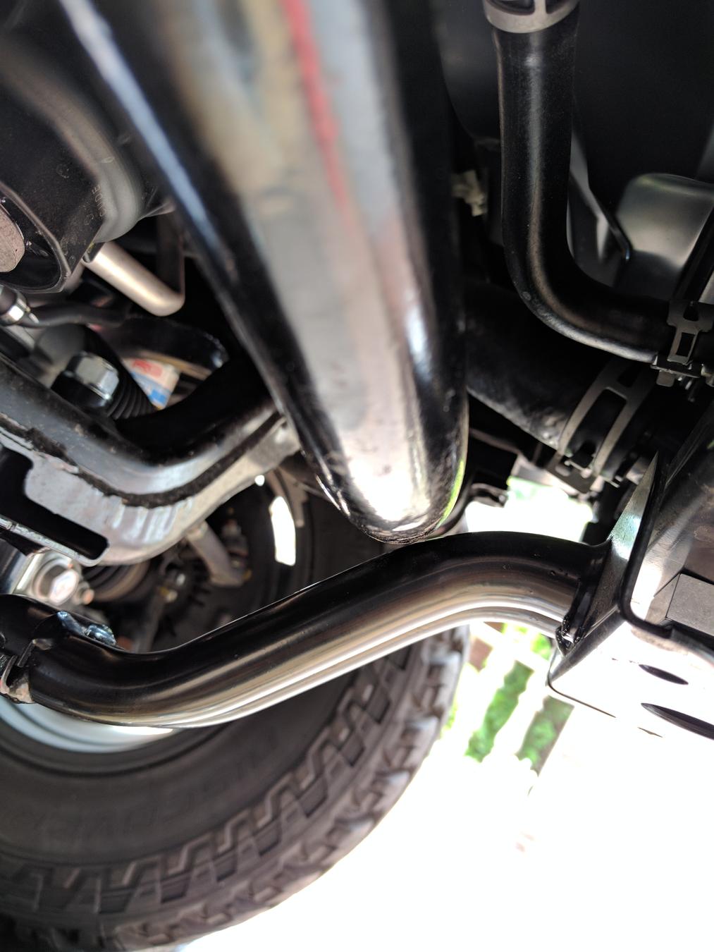

Didn't install bp-51 yet. But installed the bp-51 sway bar relocate, toytec radiator support drop, and a diff drop I got from Amazon.
Sway bar is 1sheet of paper away from radiator support on drivers side.
