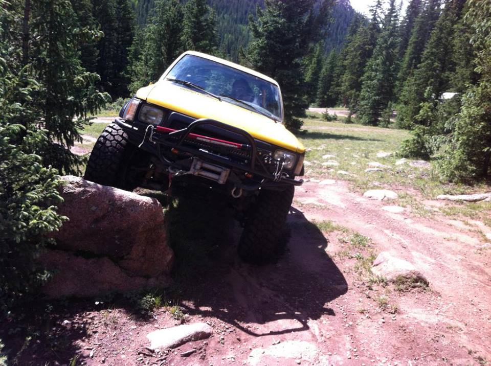

2-3" OME suspension lift and big fat tires. It works!
