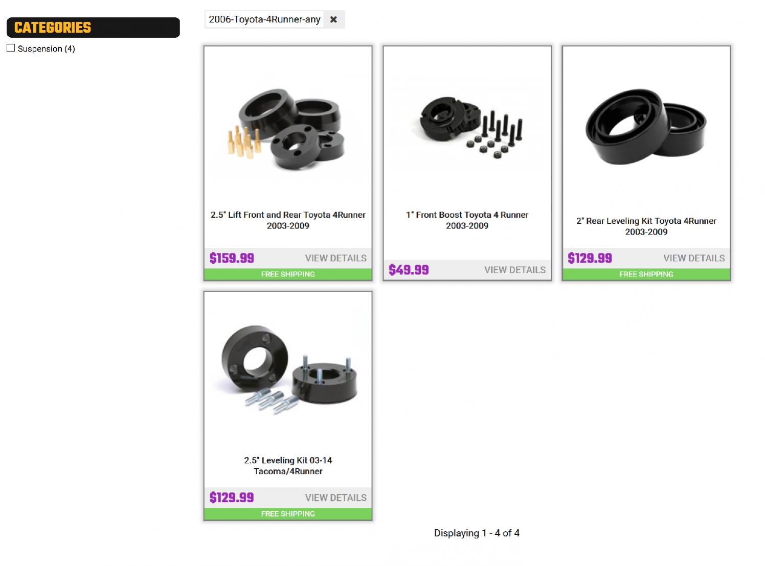

Yeah I keep seeing that referenced in (decade old) posts. A "Daystar 2.5 / 1.5" but I cant find that product. These are the only 4 things on the Daystar website when you rank by 2006 Toyota 4Runner:
