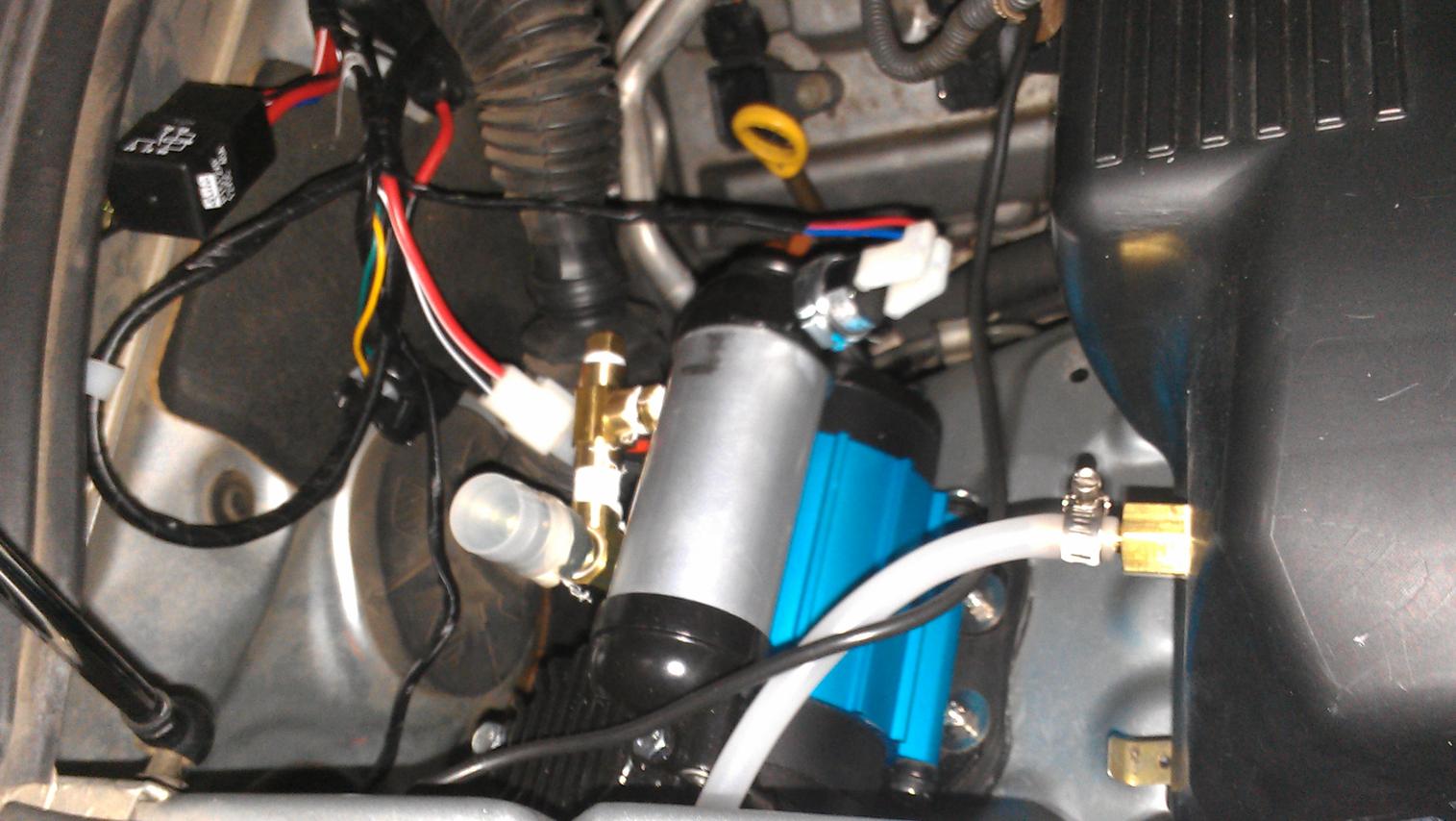

If you are going with ARB lockers I would go with ARB compressor. That way I would have a clean system. Actually that is what I am doing. I have the ARB single compressor mounted under the hood and I am getting funds together for the locker, rear only.
I think Crashman did a neat setup using VIAIR in the compartment where his spare tire was.
As mentioned earlier. installed on passenger fender between the intake and 2nd battery. i also installed a Blue Sea fuse box over on the driver side to add a second layer of control and protection.
