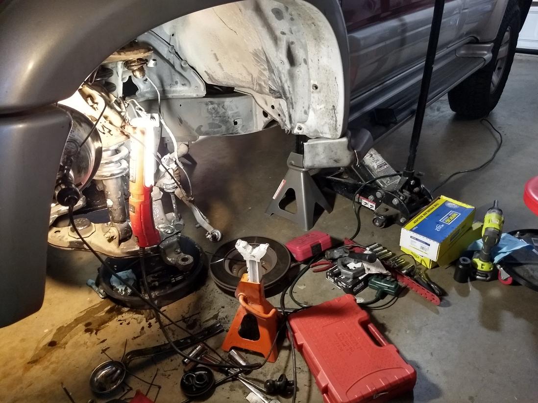

Update

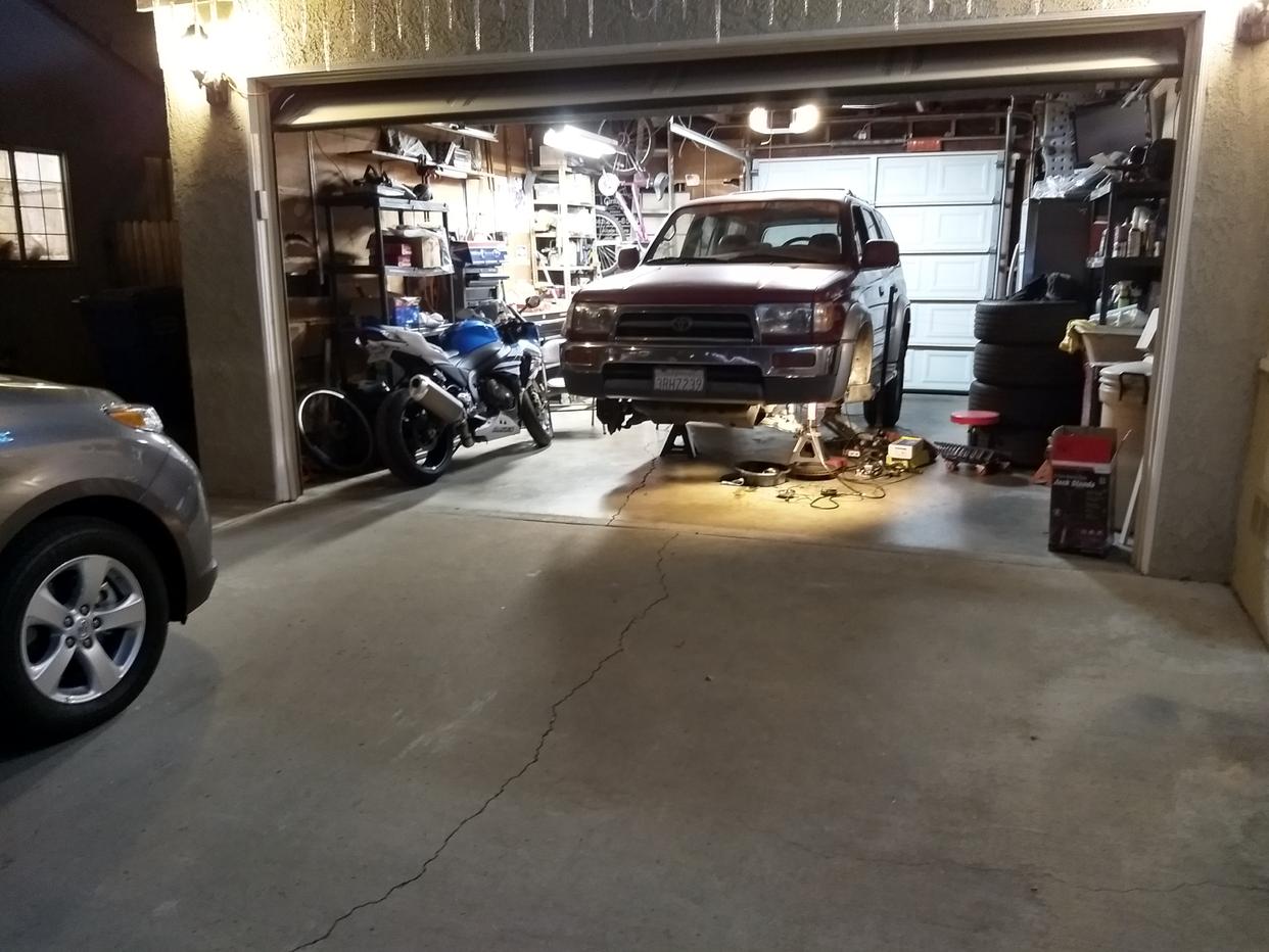

Hello, Adam here (MSDOS) brother, figured after reading this thread on the forum I would give an update, so we finally were able to get her situated in my garage I am going to take a crack at it this weekend. I appreciate all of the tips in the forum!
Also included what is usually in the garage :cool:

Update 2

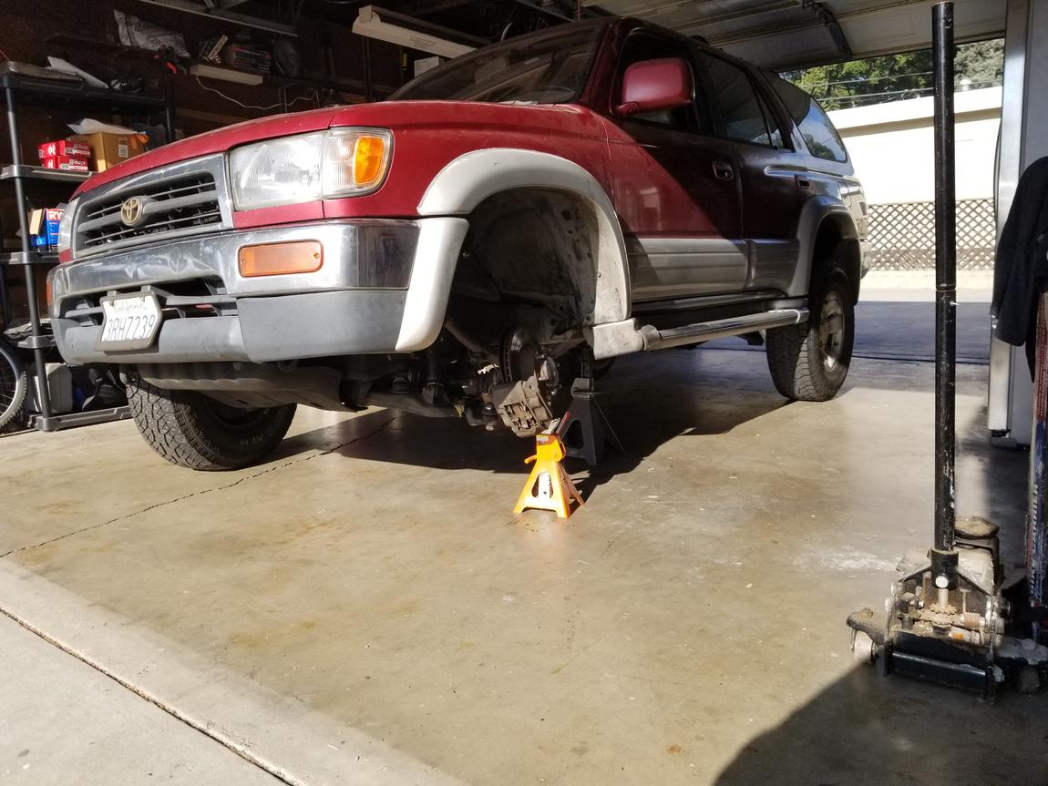

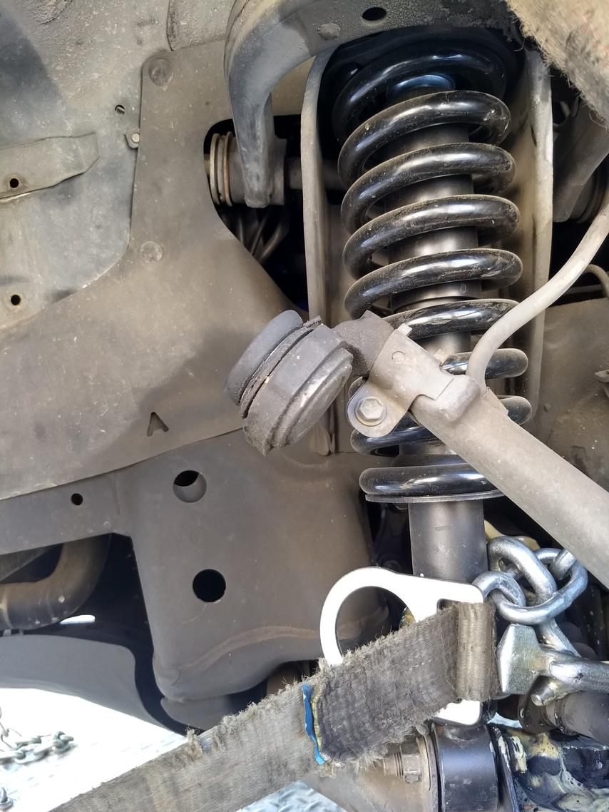

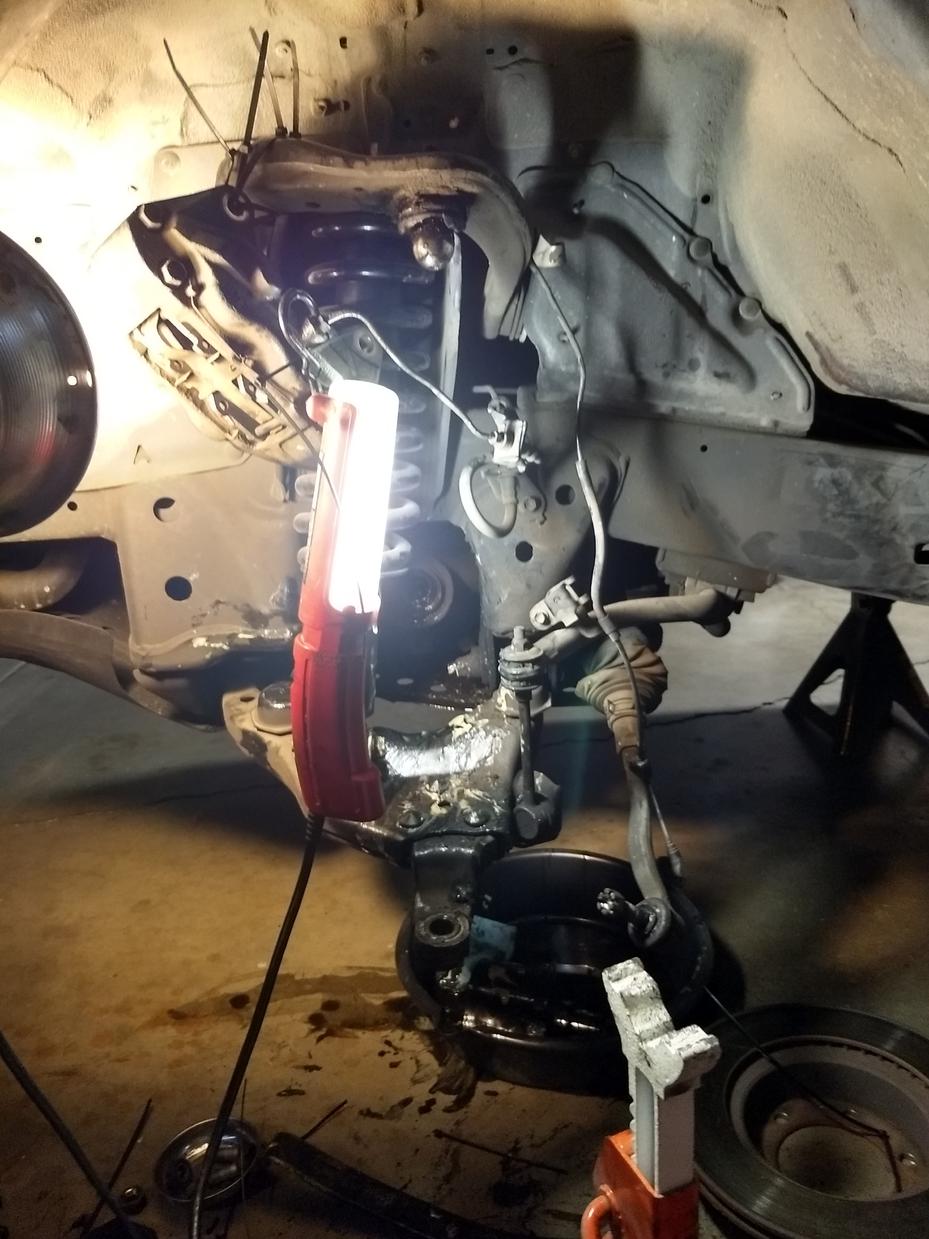

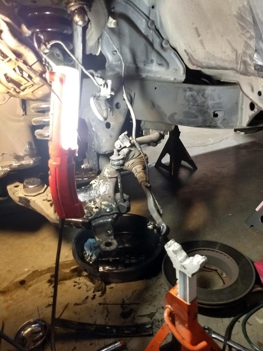

Hey guys I figured you would be interested in an update. So my brother and I have begun repairs, due to to time constraints we decided to go with aftermarket parts from Webber's in Montebello. They are MOOG, we are replacing the driver side UBJ, and both driver and passengers side LBJ's along with the driver side CV axle. Getting that damn "Tulip" off was a *****. We quit tonight because we have to go get the old UBJ pressed out.
