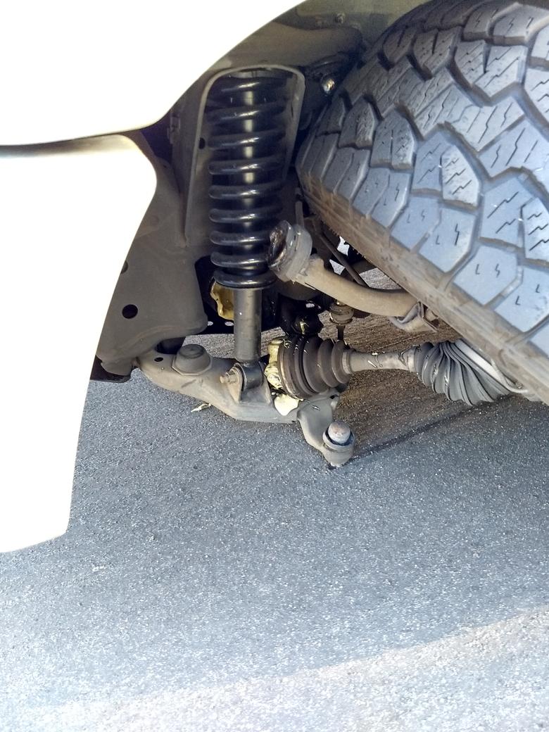

On my way to an interview in my daily driver,......ball joint failure

Moog is fine for everything but the LBJ. You'll want to buy OEM and do that again soon. They only last 20k-30k (often much less) vs the 100k+ of OEM.
They'll do fine in a pinch to get you back on the road, but I would not consider it long term.

Agreed, please reconsider OEM at the least for your LBJs.

LBJ - Go OEM
UCA - I have no opinion on OEM vs Aftermarket
CV - Rebuild or go OEM
Tie Rod Ends - Aftermarket

Update, had to find a local shop that would press out UBJ from spindle assy. Getting that done this morning, interesting the negative feed back regarding moog BJ, I have used them before on a 1990 camaro and a 89 Camaro, never had issues with them, the only reason I can come up with is you guys are off road enthusiast and there for really put these ball joints under stress, as in this application is might see gravel road once or twice but that would be the extent of off road. I have a feeling they should be fine.

I'm gonna be a little harsh here. Do you really think your Brother knows more than us? People that are here every day & are addicted to their 4runners????
You already made one big mistake by not changing your old OEM LBJ's. It could have cost you or your passengers your lives on the highway or mountain curve! (and being a member since 2012????) A POS early 90's American car is not a built in Japan precision instrument. These LBJ's have tension on them not compression like other BJ's. Moog ball joints fail, will it be 1000 miles or 10K?? Who knows?? Have fun playing Russian Roulette.

Flame wars & trolling is not allowed on this site except for the occasional joking around/ball busting between friends. That's why this site has so much traffic. We share knowledge & experience. I'll have my '99 18 years on Jan 6th. These ball joints are under stress all the time because of the design. Only OEM can handle it. Do a Google search, 95% of LBJ failures have been on road. Most off road rigs change their original LBJ's to new OEM before going off road. I'm not going to argue with you, take our advise or leave it.
If I bough a used 4runner with Moog LBJ's I wouldn't even drive it until they were changed out.

The general consensus on this forum, after seeing dozens and dozens of failed aftermarket LBJs is that
using Moog LBJs is a really bad idea.
It takes an one extra day to get the OEM ones from an L.A. area dealer: Order by 5pm, in tomorrow at 9am.
Good luck...seriously.
If there's an achilles heal on our rigs, it is absolutely the LBJ's. Just to re-emphasize what everyone on here has already said = ONLY go with OEM, and replace the four bolts. The damage done, if you're lucky, with a failed aftermarket LBJ, far exceeds the cost of OEM LBJ's.
