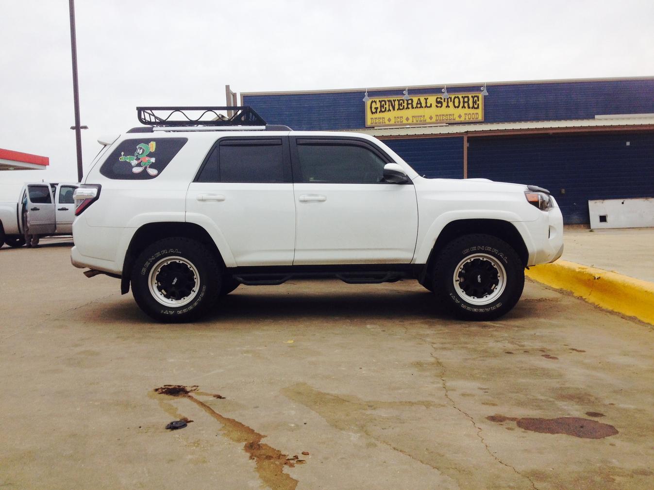

The 0.85" setting is the one that actually still leaves you with a slight forward rake, and is considered leveled when unloaded.

No measurements but -- 0.85 and stock in the rear looks like this. 1.75 without a 1 inch spacer may look tail low with a load.

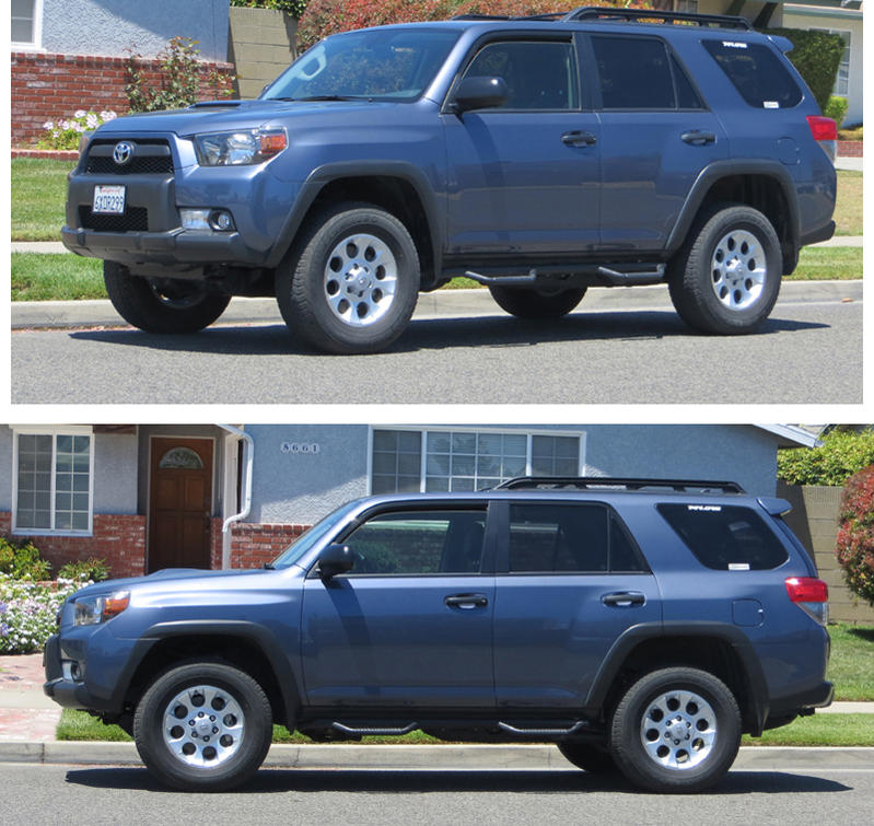

Hope you read this before you install 5100's.On my SR5 2014 I installed 5100's in the front set at the 1st notch up from stock which should have been a raise of .85 inches and the rears with no spacers. This setup actually raised the front exactly 1.25 inches and the rear remained the same as before.I know yours is a trail and mine was an SR5, so you could end up with some reverse rake which I think is a terrible look, you may be ok with this. I was really glad I did not ose the 1.5 notch. I know they all different but??????

You will be happy with .85, which will give you 1" lift, maybe a tad more. That is what I did and it is perfect. 1.75 will give you reverse frame rack unloaded, loaded rear and it just looks silly.
If you go 1.75, you need to add a 1" rear spacer to not look odd driving down the road.

Agree. While a very few like the 1.75 setting, the vast majority use .85. This leaves you with a slight forward rake, but fixes the more dramatic stock rake, which I did not like.
Remember, this is not a permanent setting. While you'd have to remove the shocks to change them, it CAN be done.
Don't forget to realign your headlights.
I also went to .85 a couple years ago and have no complaint with my 2014 Trail premium. Has a slight rake that evens out when loaded up.
