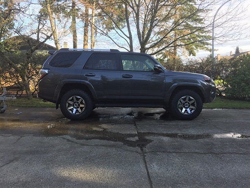

Before and after measurements:
Before:
DF - 34
PF - 34 1/8
DR - 36.5
PR - 36 3/4
After:
DF - 35 3/4
PF - 35 5/8
DR - 37
PR - 36 3/4
BEFORE
AFTER
excuse my ghetto boards lol

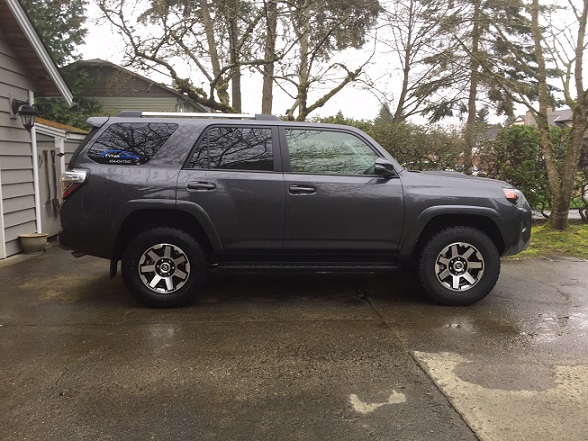

Got the Bilstein 5100's front and rear installed today and an alignment fronts set at .85" no other spacers etc 265/70/17 General Grabber AT2s. The Bils firmed up the ride a little the biggest benefit is the significantly reduced nose dive when braking, it's hard to tell from the pics the truck sits closer to level with a slight nose low rake not really nose low like stock. Very happy with the result money well spent.
Fender measurements at the center of the wheel.
Before:
Drivers front, 34.25"
Drivers rear, 36.50"
Pass front, 34.50"
Pass rear, 37.00"
After:
Drivers front, 35.50"
Pass front, 35.50"
Pass rear, 37.25"
Left pic before, Right pic after.
