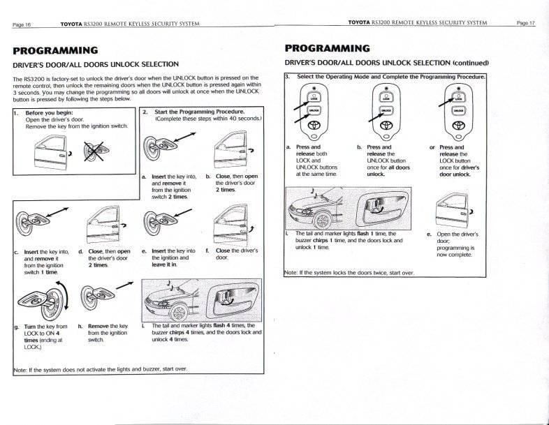

I would love to be able to hit my button once to unlock all the doors, and was just trying to do this today, but could not get it to work on my 06 limited. Attached is a copy of the directions I was following for the RS3200... but as far as I know mine could be a RS3300 or something different.
Does anyone else have a procedure like this that worked for them other than taking to the dealer to have them try to do it for you?
