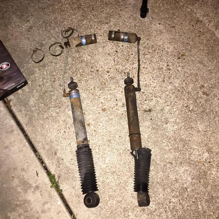

This is what [MENTION=141287]FiReBReTHa[/MENTION] is referencing. However the most recent failures seem to be from top-out due to too much lift. As I see it, bumpstops could only help that in flexy situations.
I was reading through [MENTION=50186]adio3x[/MENTION] build thread and he put the 5160s through the ringer as you can see from the pic that I stole from his thread. Here are a couple quotes from his thread that I thought people here would benefit by reading. I guess Im going to be picking up some rear bump stop extensions.
Those were my 3rd set. Probably got about 20k out of each set. Word of caution, get extended bump stops if you want to run those 5160s. Toytec stopped honoring my warranty after the guy that I had been working with left after the 3rd year. Told me to talk to Bilstein and they were saying it was installed incorrectly, which is BS.
I never had bumpstops on while I had the 5160s on, which was my first mistake. I put them through the ringer, very harsh desert bombing in utah & very flexy off cambered rock crawling & the shocks kept bottoming out and spewing oil. I would get either a 2" or 3" metaltech bumpstop, I have the 3" right now with my icons.
