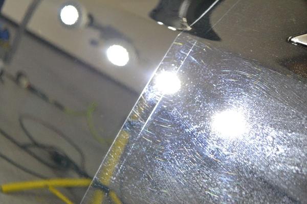

Paul just texted me this 50/50 before/after shot he took of a black Tesla sedan he is working on. Amazingly enough, the Tesla's paint got that bad just from machine car washes!
It is really amazing how proper paint correction can fix a paint job!
Even if you can't get every defect out before Opti-Coating your vehicle, I still think it is worth it. Sure you will always see those defects, but the Opti-Coat will cover any exposed paint areas, so you don't get rust, as well as protect the other areas. Plus, washing an opti-coated/guarded vehicle is much easier. Obviously you want to get all of the swirls out, but some permanently coated scratches wouldn't be too bad.

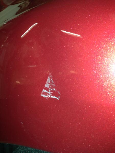

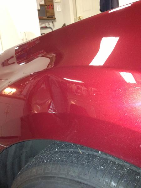

Here is another reason Opti-Coat/Opti-Guard is an amazing product. My Dad had Paul Opti-Guard his 2012 Subaru Legacy. A few weeks ago it got a "hit and run" in the parking lot on the Front Driver Fender. It looked really bad, and I was sure it would need a repaint....
This pic doesn't show the dent well, but shows the scuff/scratch:
We took it to Paul for advice, and he was able to completely polish it out on the spot, without compromising the Opti-Coat! Even if it did, Opti-coat could have been removed from the panel and re-applied.
So basically a major scratch like that didn't even touch the factory clear and was easily removed, without needing a repaint!
My dad will be doing a paintless dent repair on it, and completely avoided haveing to take it to a body shop for a new fender and respray!
