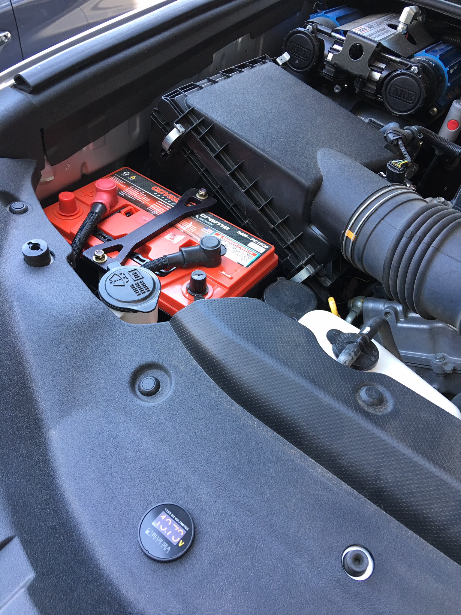

Couple of pics from my install
Ok, dumb no electric experience question here. :pout: The fuses you have bolted to the side of your engine bay, what are they and why are they there? I was thinking anything fuse related would be done through the fuse box, which looks to be mounted on the side of your main battery.
They are circuit breakers. They are typically used for handling larger loads. Simplistically they do the same job as fuses but are resettable when tripped instead of replaced. The ones you see are for the compressor and the Bussman fuse block which you see in front of the brake booster. There also a SwitchPro in the mix
