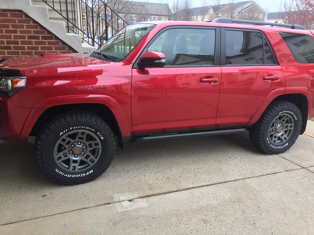

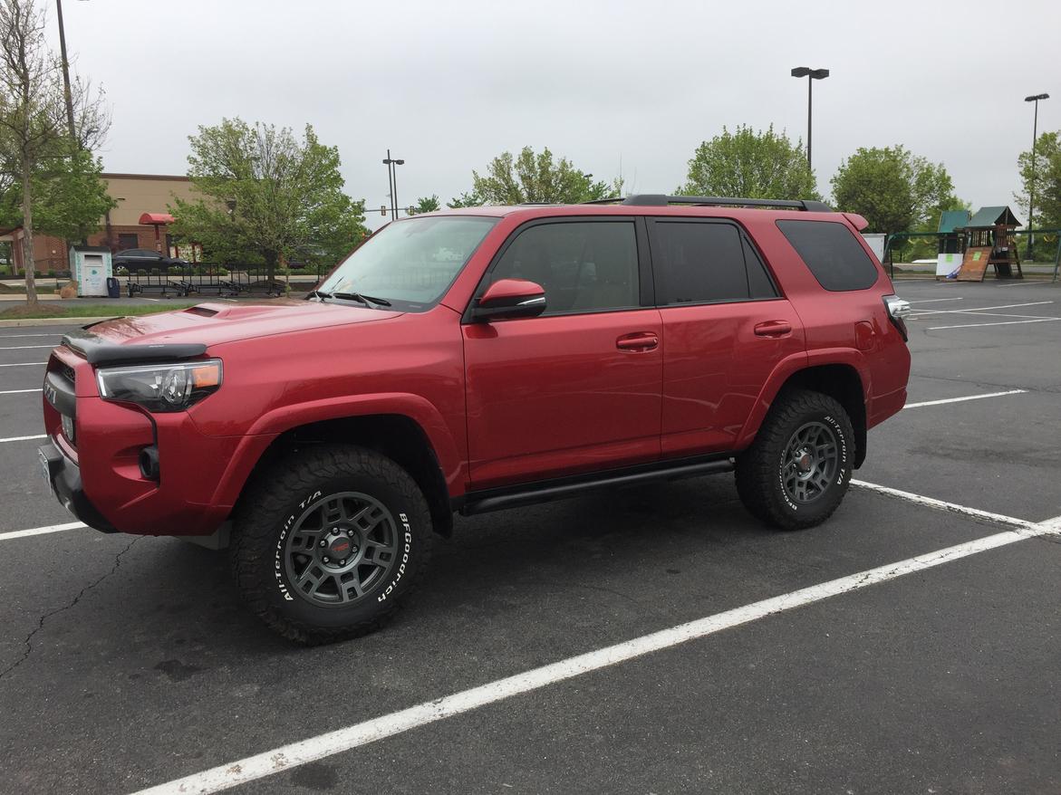

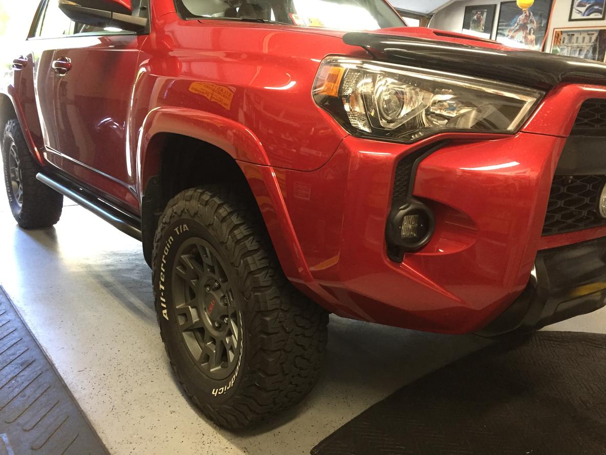

Finally got around to installing mine, had the fronts pre-assembled which made it much quicker (thanks Wheelers Off-road). Set to 1.85 with Cornfed 1" spacers in the rear. Sits perfect and rides so much better than stock.
Before with Bilstein 5100's set to .75
...time to update that signature... :yo:
Nice ride neighbor! Do these ride any better than the 5100's? How does she ride? Is it a daily driver?
Thank you. Yeah they ride a bit better than the 5100's, a little stiffer but not bad. Yep it's my daily, I'm looking at getting some UCAs next. Didn't think I would need them but the alignment guy said I was maxed on caster so I think adding them will make it drive a bit better.
