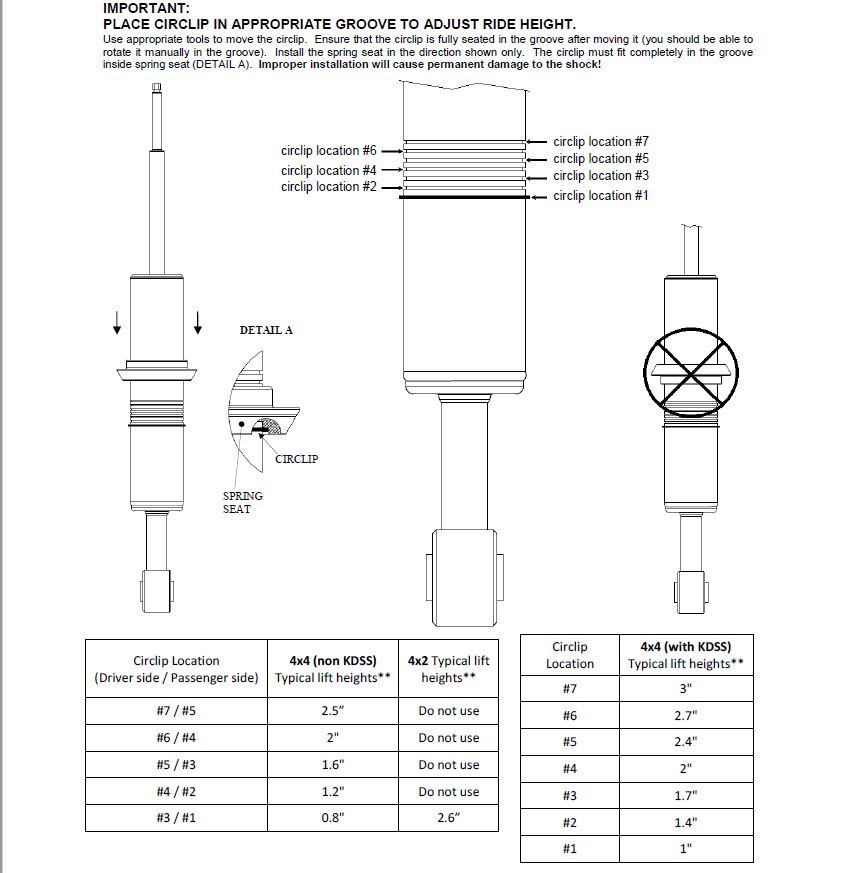

By the way here are the revised instruction with KDSS settings.

#2 circlip 1.4” setting
Has anyone with KDSS put the 6112 upfront set on the #2 setting circlip for 1.4” average lift, and left the rear end stock? Is there still a little rake? Based on the front 19.75” center hub measurement and rear 22” center hub measurement if Blistein average is right it should bring the front up to a little under 21.25”. Just wanted to know if anyone has done it and does it look good? And if Blistein averages are correct
I’d also like to know the answer to this
